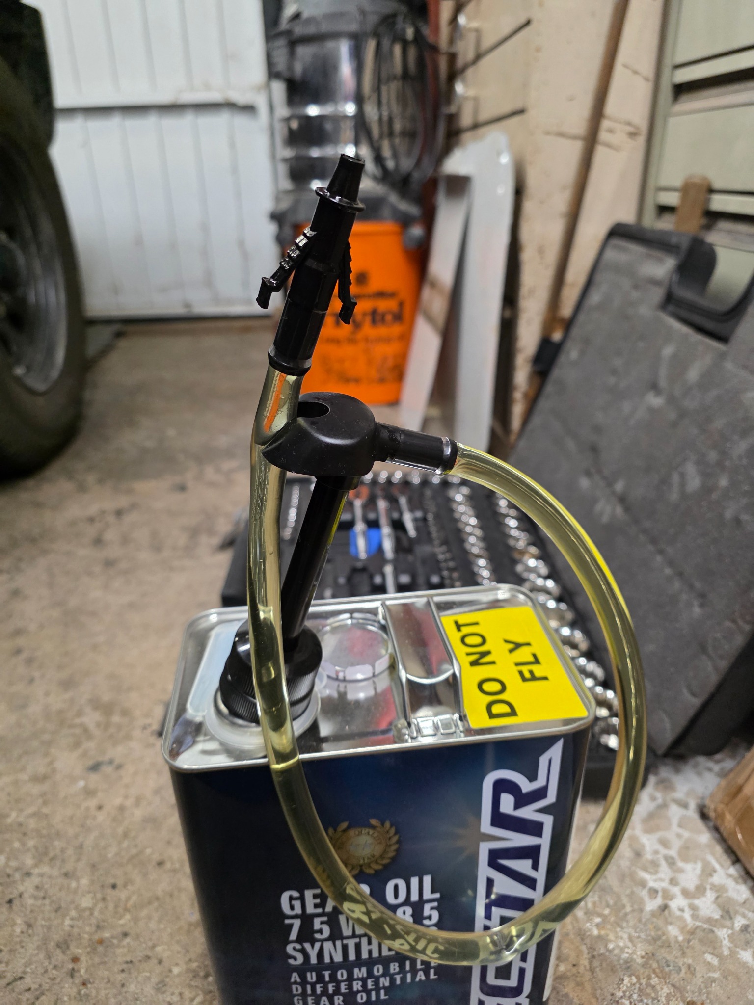

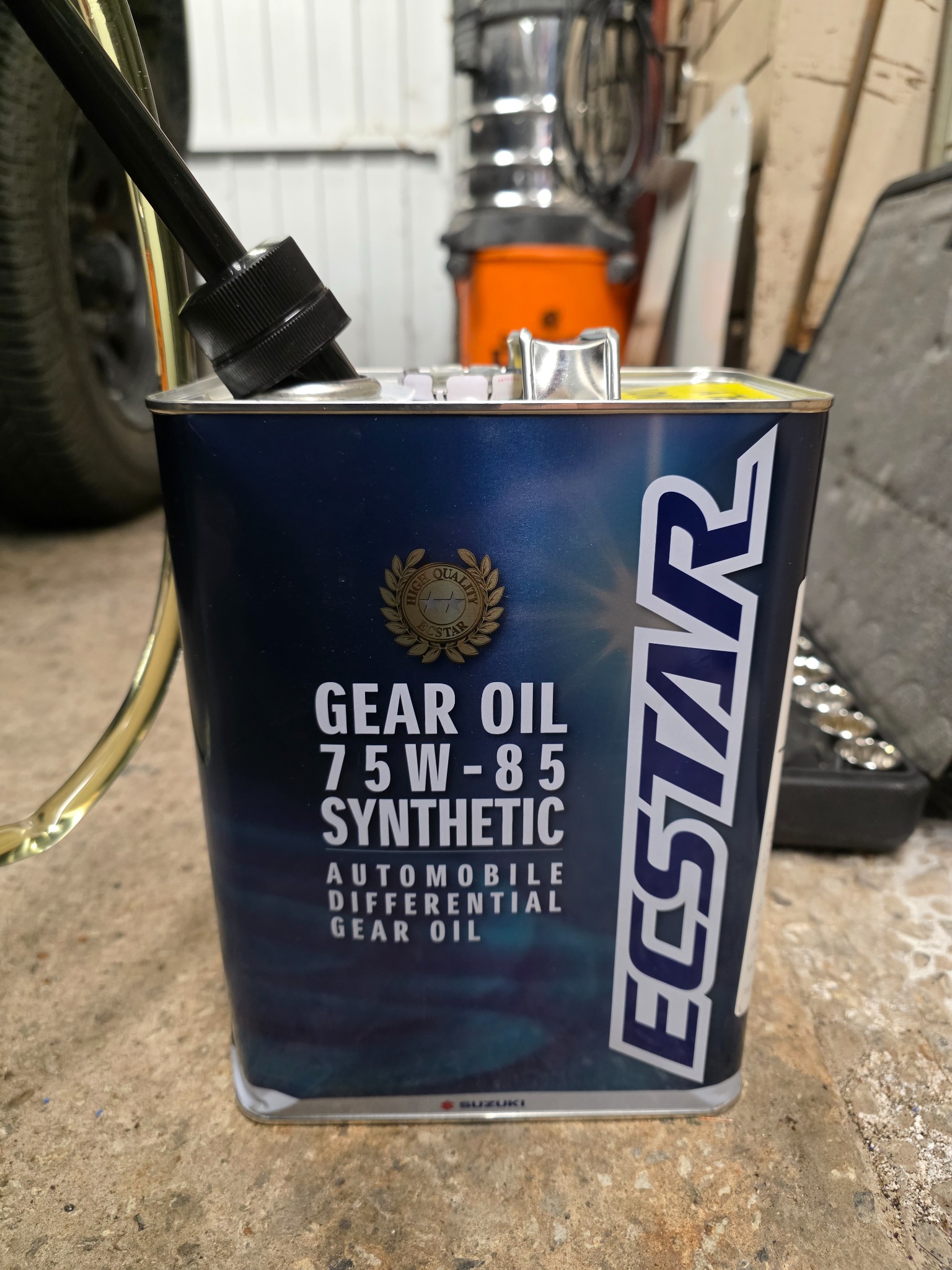

Replied by Soeley on topic What did you do to your jimny today?
Today I changed the front and rear diff oil. Seeing as it isn't scheduled for change in the service interval, I had decided to do it every 2 years. That never happened, it is 7.5 years old now. But, I am only on 51,000 miles (4 years old in miles
), so it's not too bad.
I got the proper oil as specified in the manual.
I thought it would take ages to fill up with this, but it only took 36 pumps (rear diff).
Edit: Just checked, I bought the fill and drain seals off Martin in December 2021. Shows how long I have been meaning to do this.
