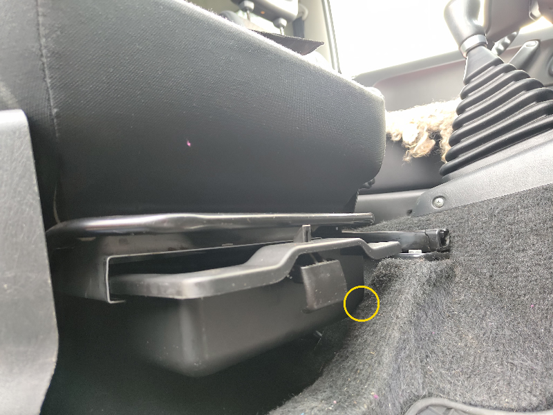

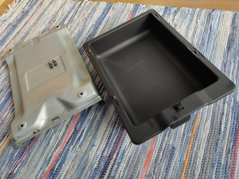

That's a pity. Can the holes in the metal lid/runner be elongated so it can be offset to the side a bit?

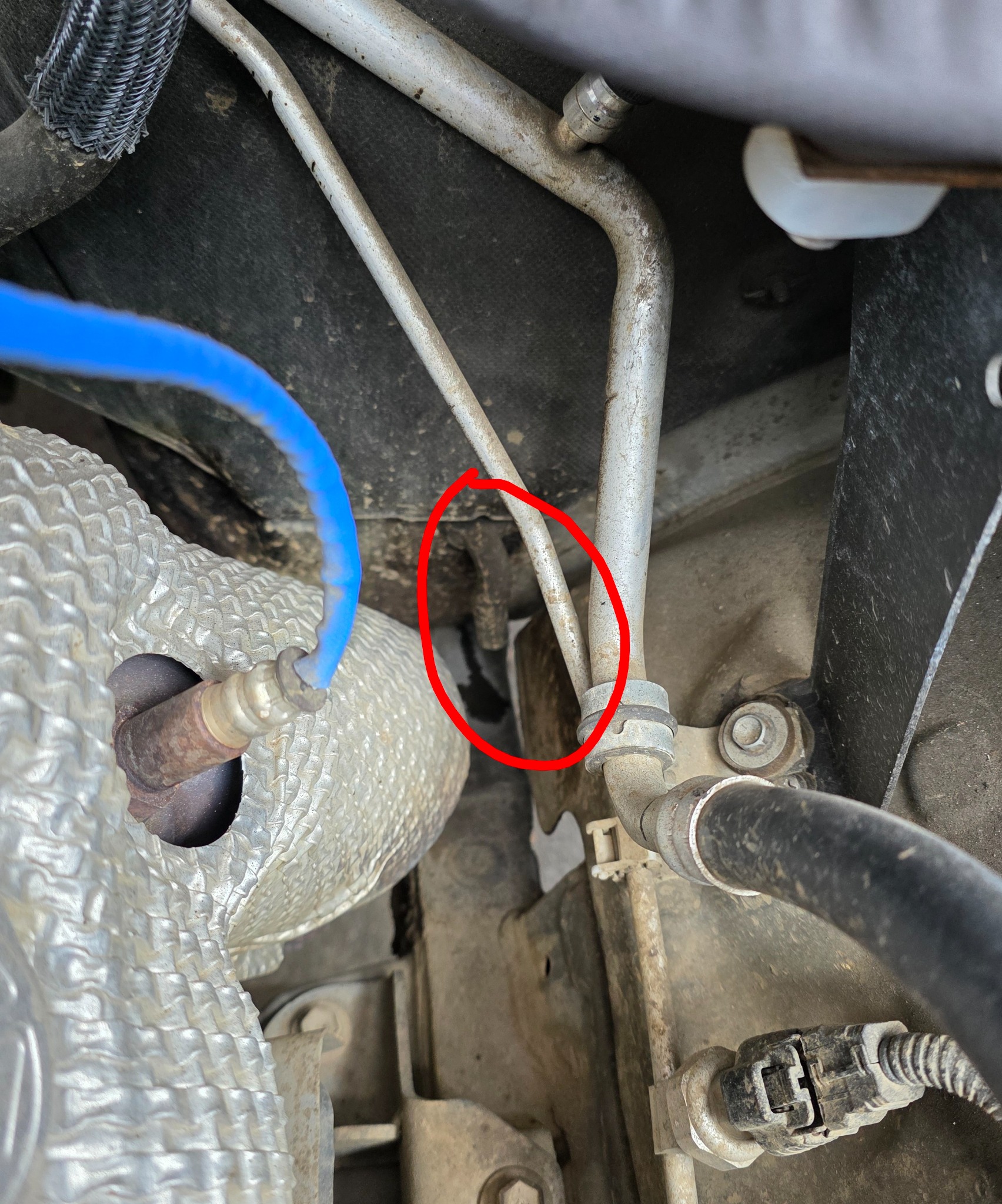

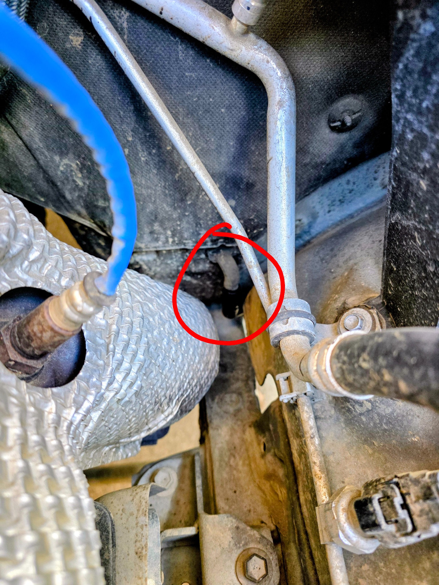

So with me practically leaving the aircon on all the time now. I have extended to condensate pipe, to stop it constantly dripping on the chassis.
The condensate pipe is right above the chasis.

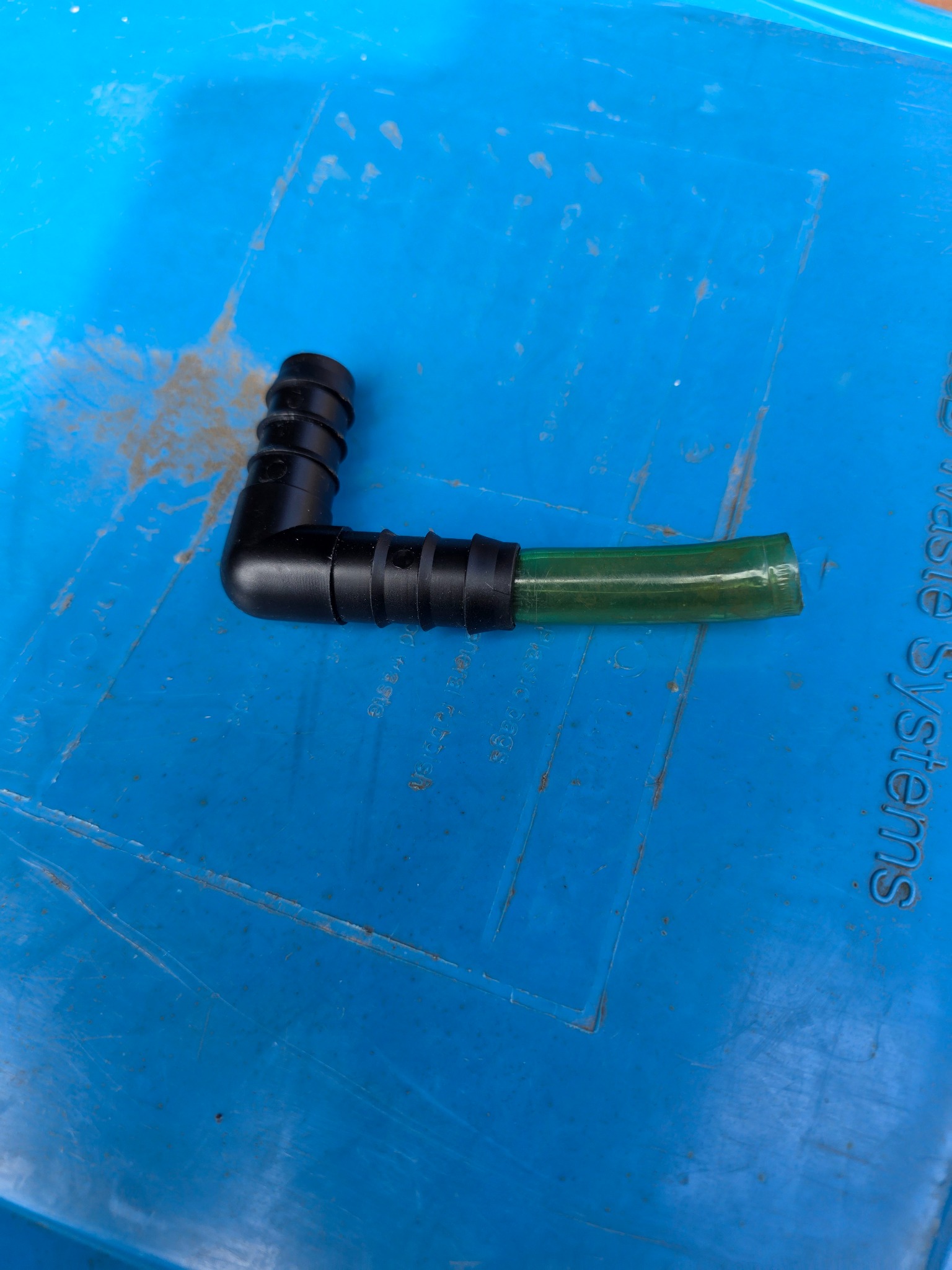

I thought I'd try a larger elbow, to push the pipe into. I didn't want to reduce the pipe I/D by pushing an elbow inside it. (This one might fall out though?)

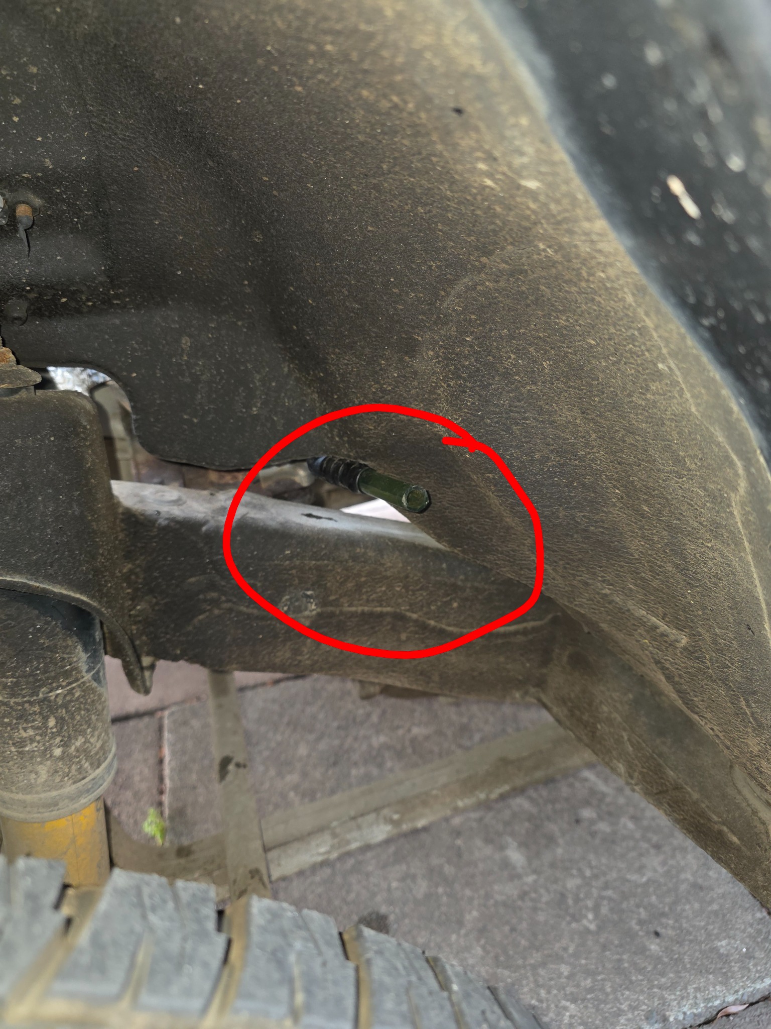

The elbow diverts it under the wheel arch.
