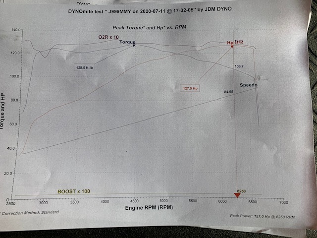

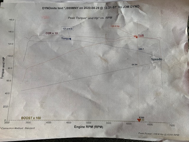

Dyno results as promised. The first one is from when it was first setup, second from yesterday with snorkel on and second injectors coming in around 4500rpm:

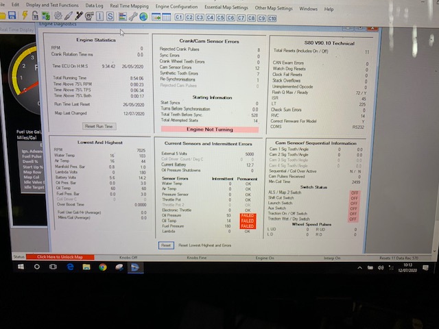

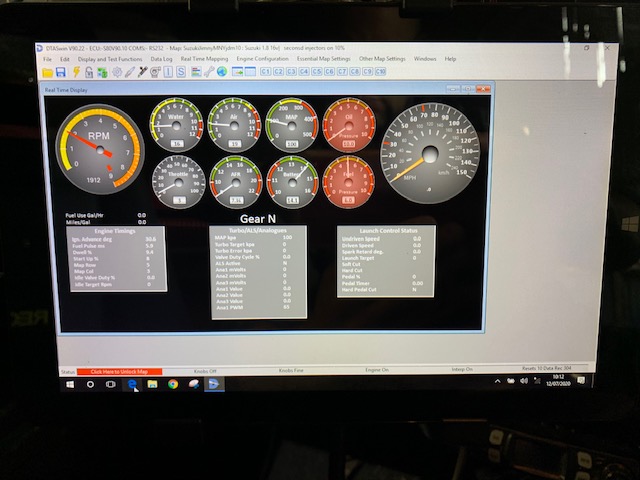

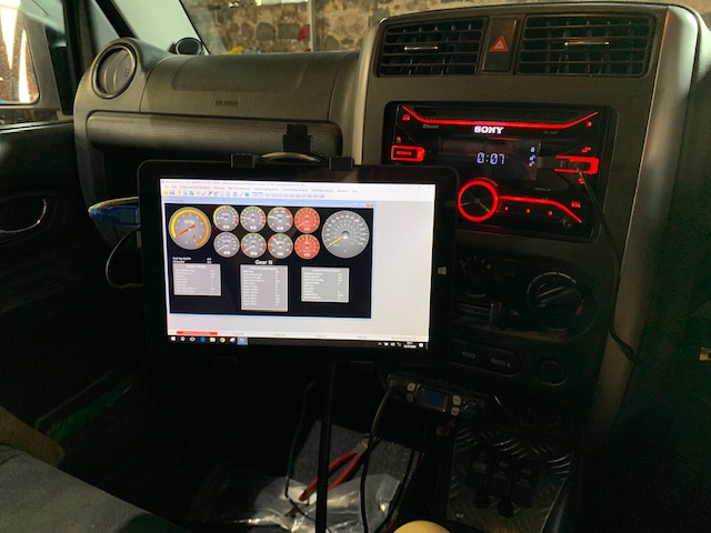

And this is the software. I bought a odd serial lead needed for the ecu setup, but it also gives you a sort of dashboard layout to view (mainly so I can see engine temp). This is an old windows tablet with a USB to serial adapter and runs the software brilliantly. Only problem is the gooseneck mount is wobbly and screen shiny/big. It'll do well to keep in glovebox for diagnosis if theres a problem and is my equivalent to the ODB reader now. I can also fiddle with what RPM the VVT starts at and a whole list of other stuff, though thats probably best left to Johnny's expertise.
