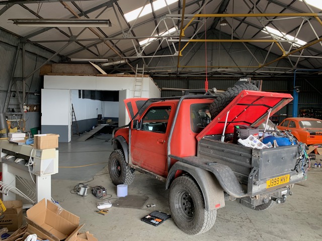

Another day at JDM Dyno today.

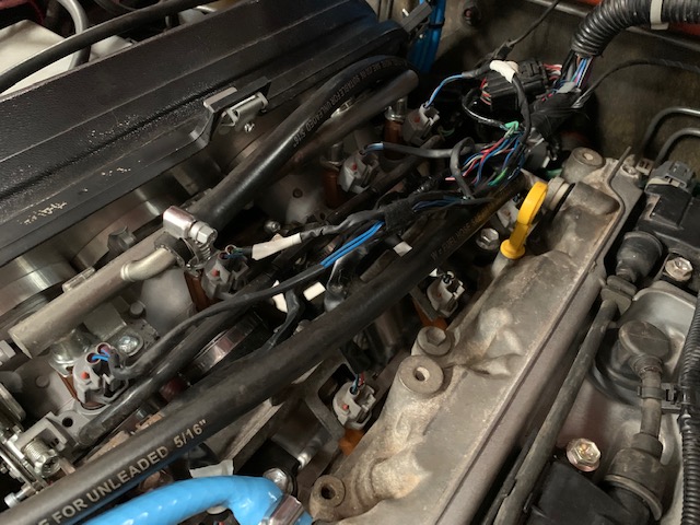

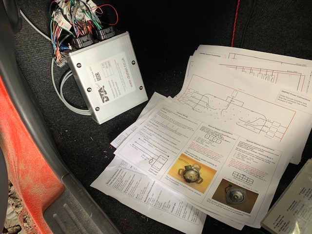

Wiring in the second set of injectors to the bigger S80 ECU. Enough spare cores on the wiring loom to use so pinched some from the EGR valve (gone) to use for the second set of injectors. Johnny did all the work again, its too complex for me!
Then onto the Dyno. Bit of fiddling with the maps (it has 2 now). 1st map is for upto 4500 rpm, then second for over that. It flips between them itself and the VVT is still in there somewhere too. A few runs to smooth it out and its going well. Power run produced about 5 more horses than the last run, but the snorkel is attached now, thus dragging it back slightly more than the original run. Shes now on 127hp and about the same in torque. I will pop a pic of the dyno graph up tomorrow (ive left it in the car and cant be bothered to go get it now :laugh: )
