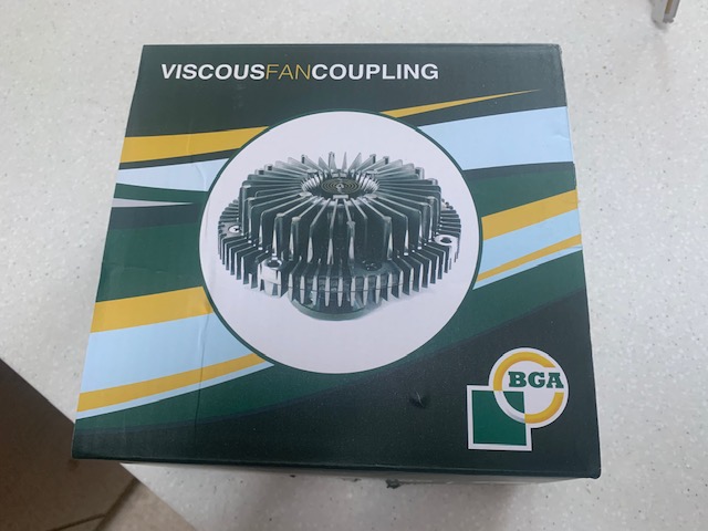

Before last Sunday's laning trip to North Wales I had a new viscous coupling to fit on. This came about as I'd been having issues with it running hot and putting the electric fan on all the time. I was even needing to run the interior heater to keep it cool enough.
I remembered Lambert was trying out different viscosity oils to see if it improved his situation a while ago (turned out to be head gasket I think). It put me in mind to test if my fan was working properly and sure enough it wasn't. When cold there was the usual resistance to pushing the fan, but once warmed up it seemed to go slack. Not right so ordered a new coupling for just under £50 and fitted it Saturday before heading to Wales. Big success! its not overheating or getting close now. Amazing the difference a simple thing can make.

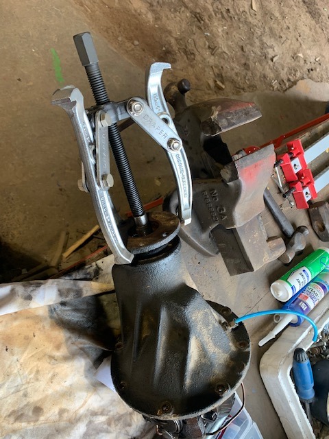

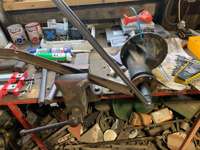

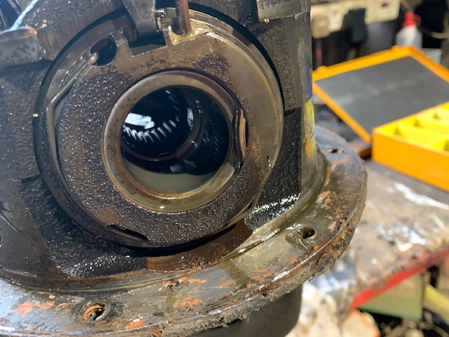

Also in the process of this the ARB seal leaking has pressurized my rear diff and buggered the pinion oil seal

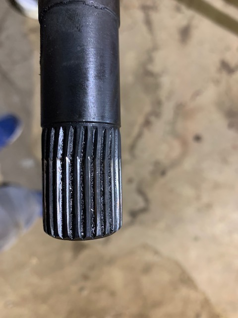

Took the rear diff out today and also found the rear shaft on the driverside has warped a bit with all the stick its had in the last 2 weeks...
so reseated the ARB seal and cant see why it popped out. Pressure tested it past its 90PSI operating range to 120PSI and its staying put?
And took the input flange off the diff to see if the seal was damaged and leaking. It didnt look damaged, and refitted its still leaking
Hence - MARTIN! I need to rebuild this 3.9 diff. I need the pinion bearings (both), the crush collar thing, the input flange oil seal and anything else you recommend? if you can supply?
