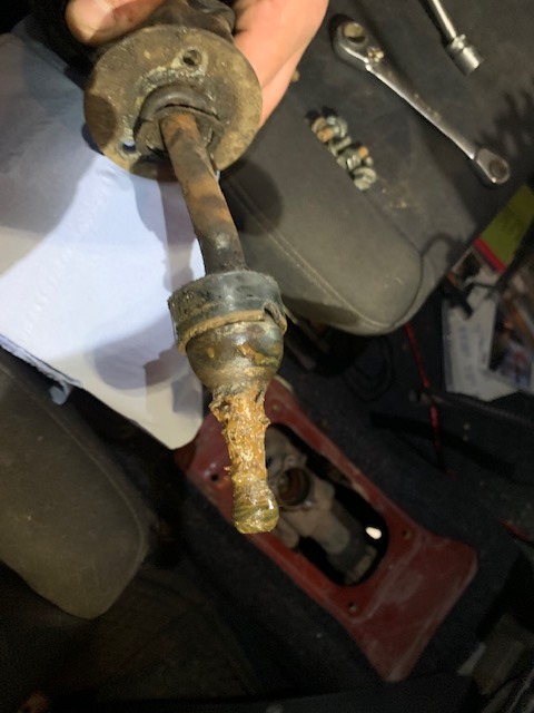

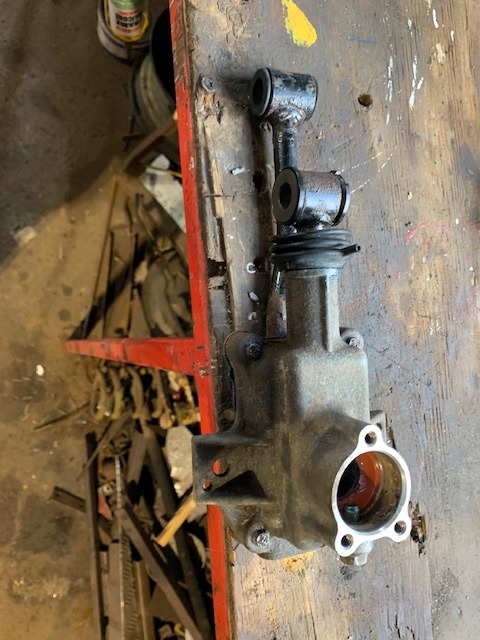

Gearstick has gone really heavy/stiff to get in or out of 2nd, 4th and reverse. Checked the oil and its full, so bit of a head scratcher for today. Have new oil to see if that helps and spare gearstick bushes. Hope its not the clutch or the box itself...

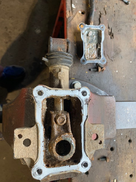

The Gearstick problem turned out to be fairly simple thankfully:
The gearstick itself, or rather the box it goes into turns out to be the problem. Took it off and opened it up to find loads of gunk and water/rust:
so stripped to bits and cleaned it all. There is a bearing in the selector shaft bit of the housing which has gone with the rust. Ive picked out all the loose bits, packed it with grease and been out for a play fairly succesfully today. Its still a bit stiff sometimes, maybe the heat is making the grease too soft. New bearings needed really:

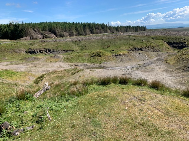

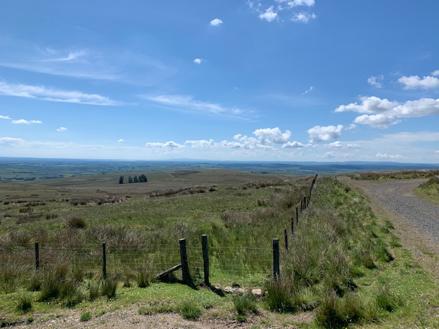

Few more pics from the top. It was beautiful up there today, I could have quite happily camped there if it wasn't for work tomorrow... and the army comms post ontop of the hill 200mtrs away :whistle:
Mad disused quarry there that looks like its seen its share of off-piste activity, no harm done really I guess :ohmy:
I didn't feel the need to venture for a play, the scenery and sounds of birds was enough
