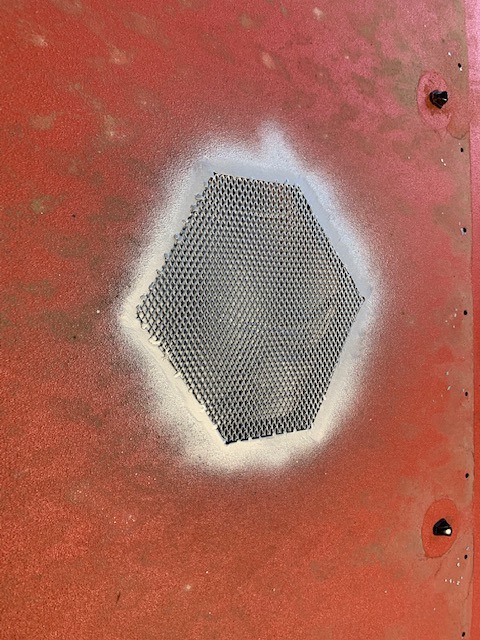

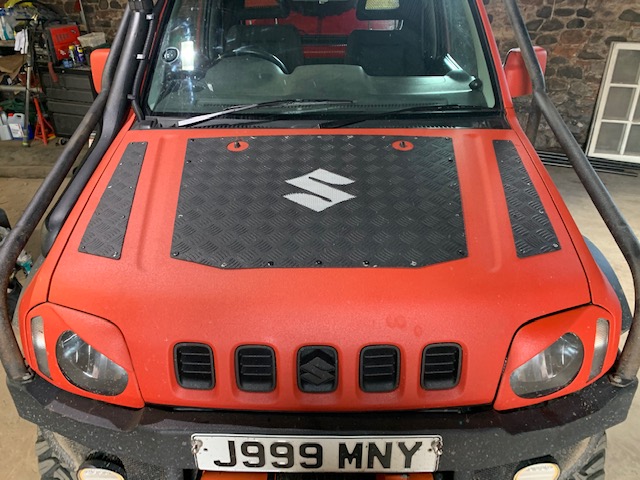

20 Jun 2020 16:26 #223786 by Riccy
Replied by Riccy on topic Ulysses
Thanks Dave!,
I had thought about back lighting it, but red at the front on the road is not a good idea (and illegal i think?), though probably OK as a toy (like my police siren :laugh: )
Looking at it again, I think the 'S' should have been about twice the size, or maybe something below it as well?

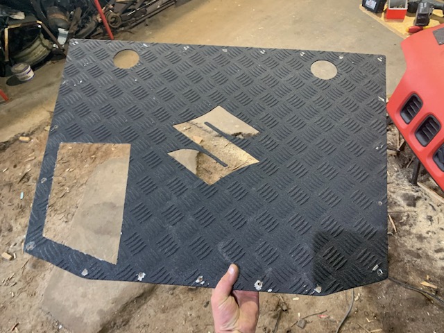

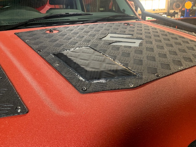

04 Jul 2020 15:13 #224489 by Riccy

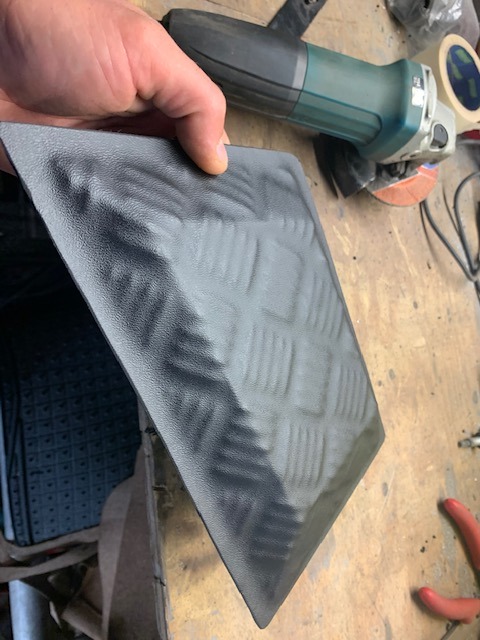

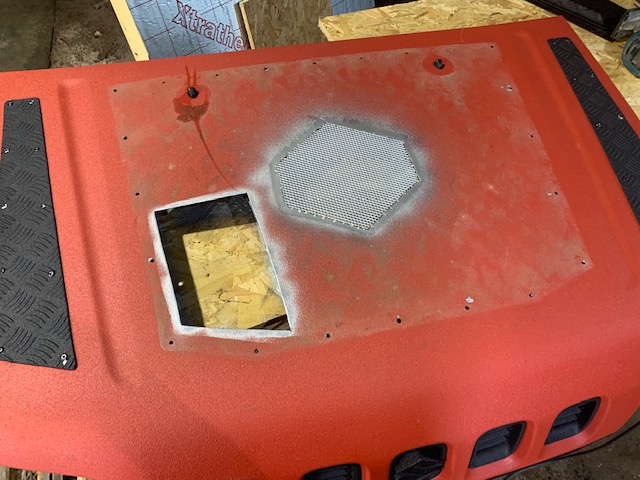

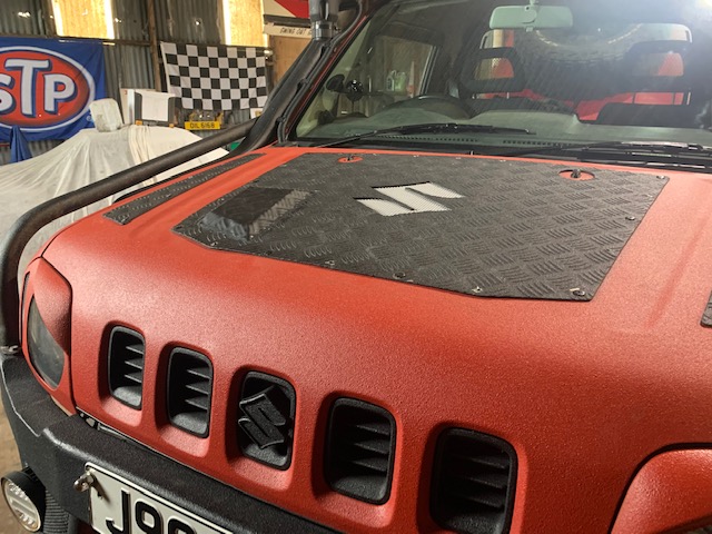

Keithy did say I would need a bonnet bulge when the ITBs went on... He was right :laugh:
The large pipercross airbox was still rubbing on the bonnet even after cutting as much out as I could, so I started looking at bonnet bulges or vents, none of which I really fancied or would work.

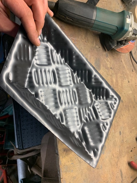

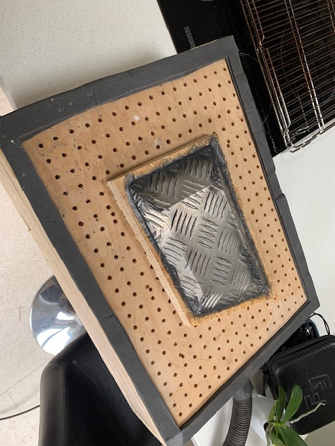

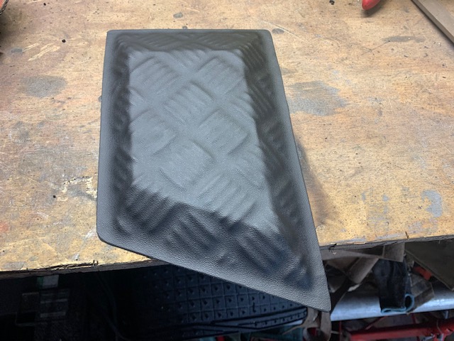

So made a template and dug out my old vac former box:
1.5mm pinseal plastic sheet clamped between two bits of board and in the oven on max for 10 mins, bung it over the mould and turn on the vac. It works pretty well for a home made thing.
Trim off excess plastic and voila:

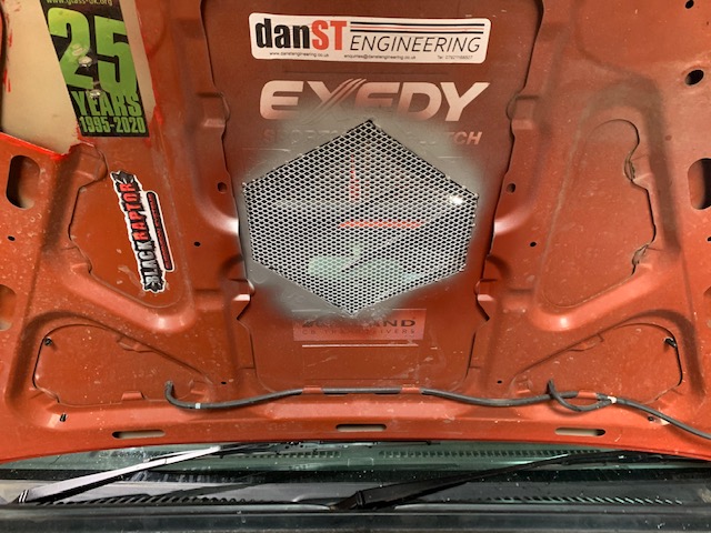

Next make matching holes slightly smaller than the moulded plastic and sandwich the new bulge between the bonnet and the S plate with a bit of sealant to tidy it up and primer on the cut metal:
Worked out pretty well. The bonnet finally doesnt catch on the airbox and theres room for everything to move about easily. Result B) cost £10 for plastic :-)
