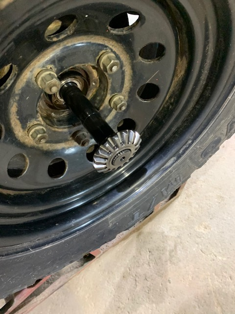

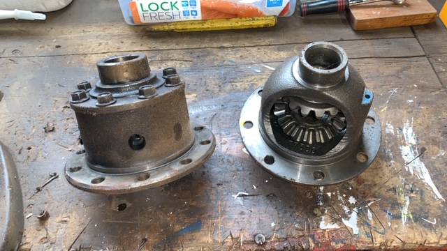

This is the two front and rear diff centres from the grey jimny. A quick chat on our group whatsapp told me that the one on the left is for the rear. Confirmed this with a spare rear shaft and it fits (rear is 26 spline, front is 22). Interestingly the rear side gears can be interchanged with the front for those wishing to use 26 spline front shafts (stronger)...
With the side gears out I tried them on the hub end of the shafts and discovered that the shafts are the same spline count at both ends. Happy days! :laugh: That should make the machining process easier and possibly cheaper, fingers crossed :-)

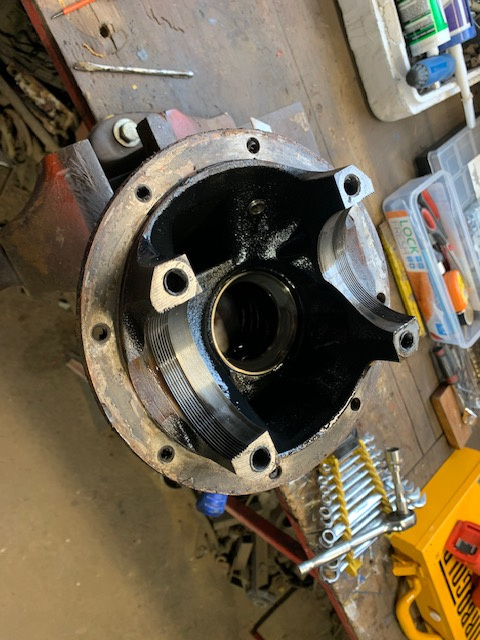

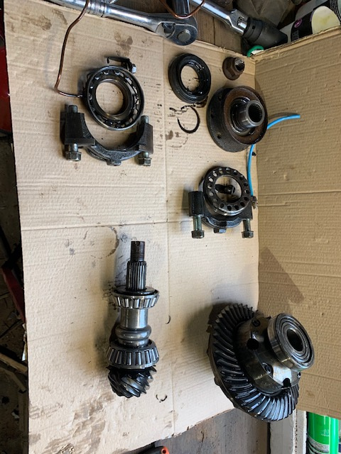

Next was to pull the diff out again as it was still leaking from the pinion seal :angry: I had ordered new bearings, seal and crush tube to redo it all. Once I had it apart I realized the bearing pullers I have wouldn't work to remove the old bearing race's and also I dont have the correct mandrel for my press to refit them. Old bearings cleaned/inspected and they seem sound so will probably reuse them. Seal to replace obviously, but the crush collar puzzled me a little. The new one is exactly the same size as the one removed. I did look into the solid one Roger mentioned, but I can only see lowrangeoffroad as a supplier and they are in America so shipping is extortionate.
So its read the FSM a bit later and stick it all back together tomorrow, hopefully with no leaks :-)
