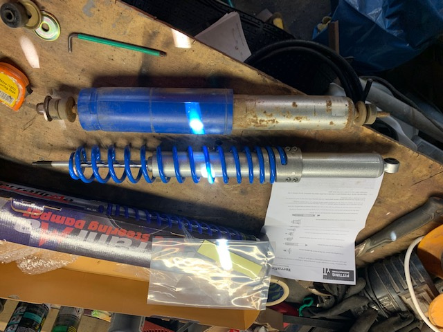

The steering damper had been bugging me for a bit.
The one on Ulysses was a left over from the grey one and been fairly well used by now. It still works, but has a little soft spot in its travel, which is weird?! I was getting issues with bump-steer at speed so decided to buy a new damper for it (rather than a whole new kit). RTC is something I had wanted too add as well.
The brackets are ones that came with the original damper from Dave and are still as strong as they day he made them.
Balls! the new one I had ordered is for a defender and is 1) longer and 2) different fitting (eye instead of pin at one end). Its also RTC (return to centre) style, which means the spring forces the steering back straight if left alone.

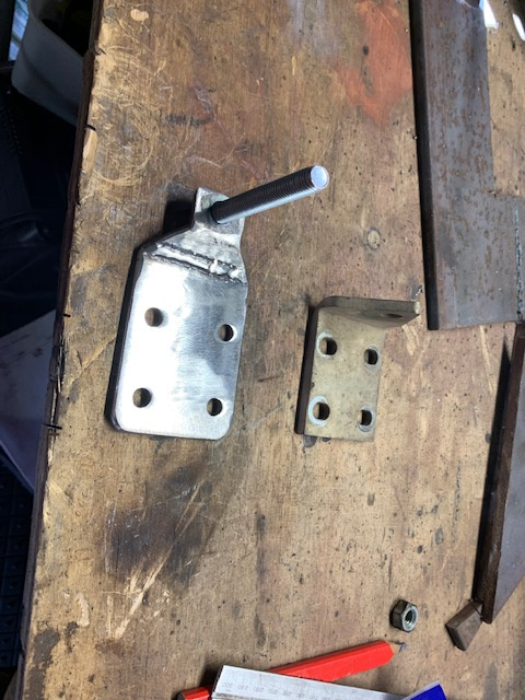

Old one off and new bracket made for the steering arm end of it:

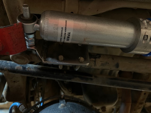

OK on the test fit so new bracket off for some paint, then as it had dried in 3 hours, it was full fitting and test run out.

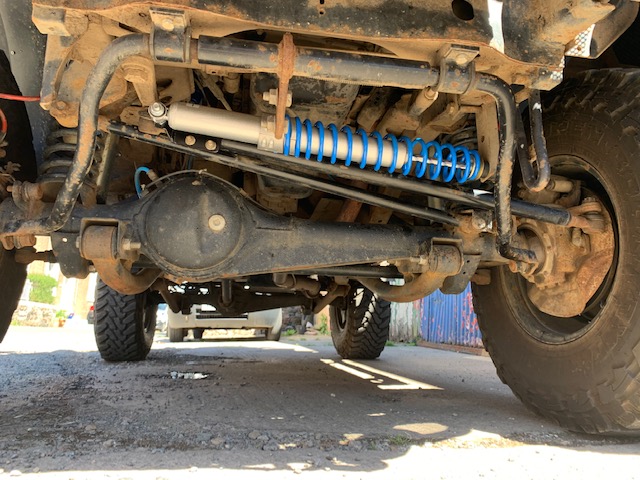

Works well. The steering self centres much better (even when not moving, which is a bit disconcerting!). It doesnt feel any heavier than before and seems to help with the bump steer from the short test run out. Overall happy with it and it only cost £65 for the damper/spring combo
