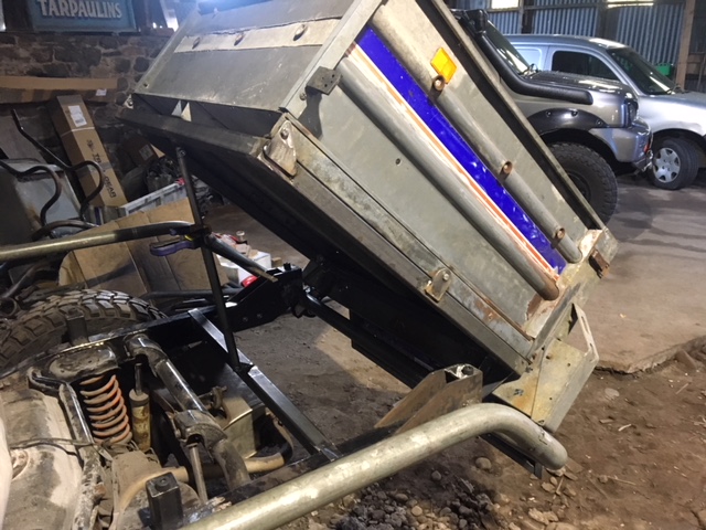

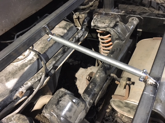

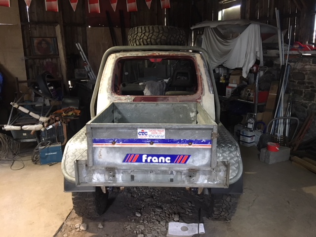

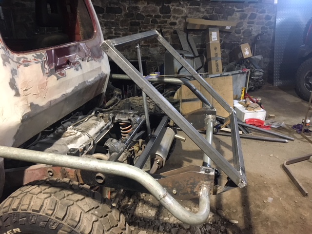

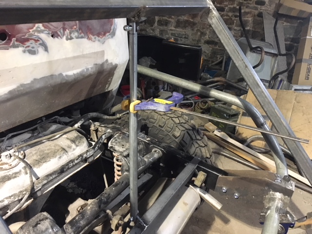

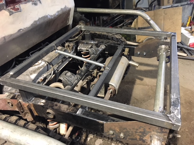

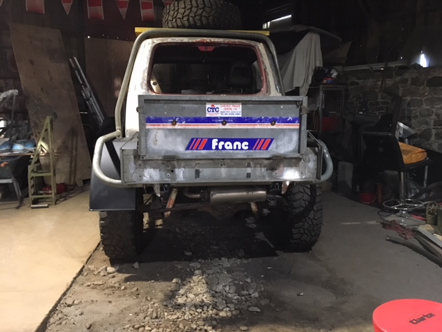

So today was fiddling about with the tipping mechanism mostly. Made up a couple of bits of pipe to represent the actuator. Brackets onto the frame and a cross brace between the chassis rails. Movement is only 200mm on the ram to achieve this sort of tip:
Then made some little tabs to bolt the trailer body onto it:

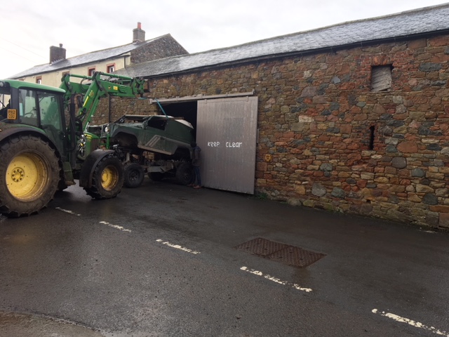

Slightly distracted having a laugh at the farm lads across the road trying to remove the [bent] body from a defender. Note the young body about to get trapped by a swinging lard-rover, suspended from tractor forks by rope and a bit of wood :blink:

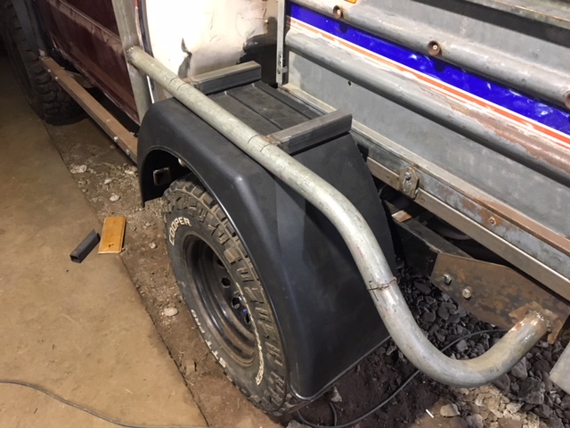

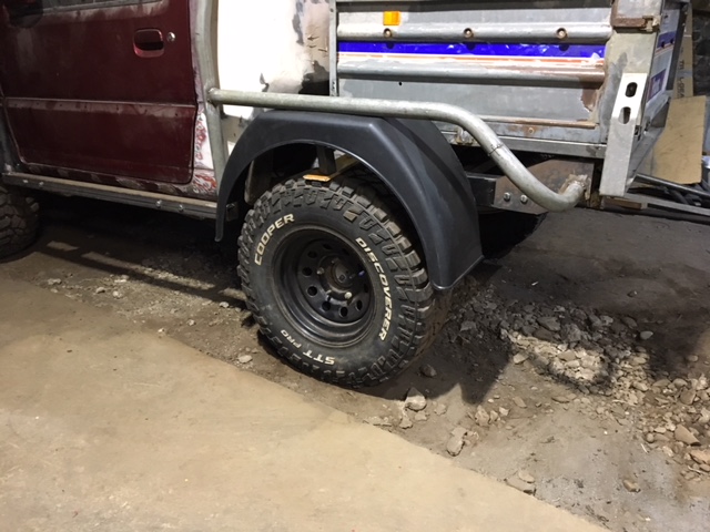

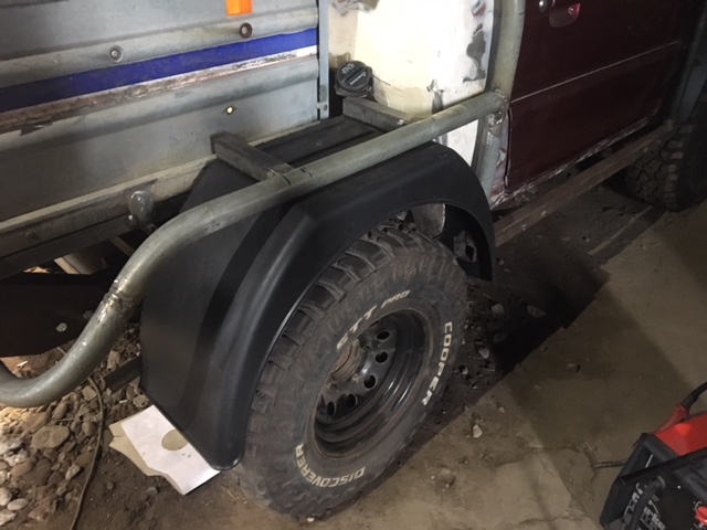

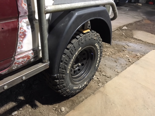

enough of that entertainment (they managed ok and no injuries to report). Bit of trial cut and fit on the rear arches...
Not bad, just need to neaten up and make some brackets for them

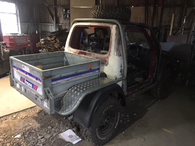

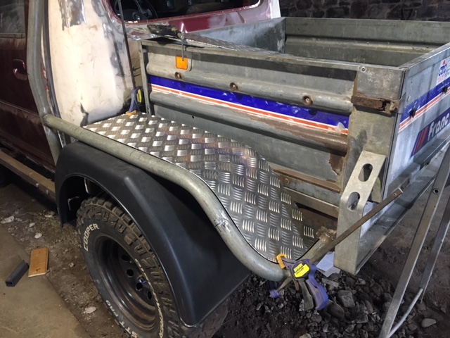

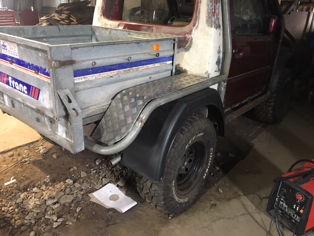

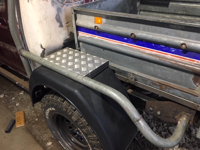

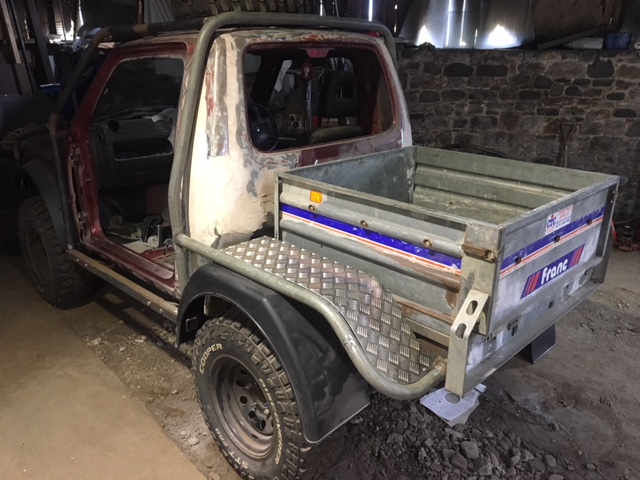

Made some rear mudguard brackets and a checker plate for the top:
Decided I didnt like the small bit of checkerplate so made some bigger bits and lots more brackets so its strong enough to stand on:

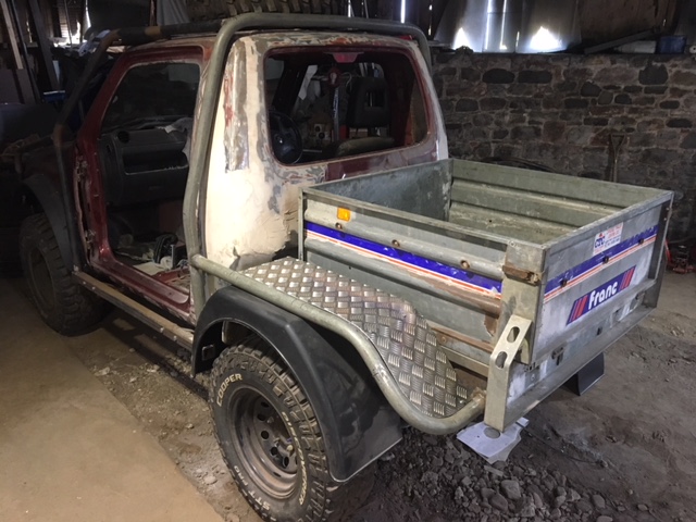

Then back home it was onto bolting down the side plates:
They are pretty good now. I have some rubber edge trim to go on once painted up and some sexier bolts.

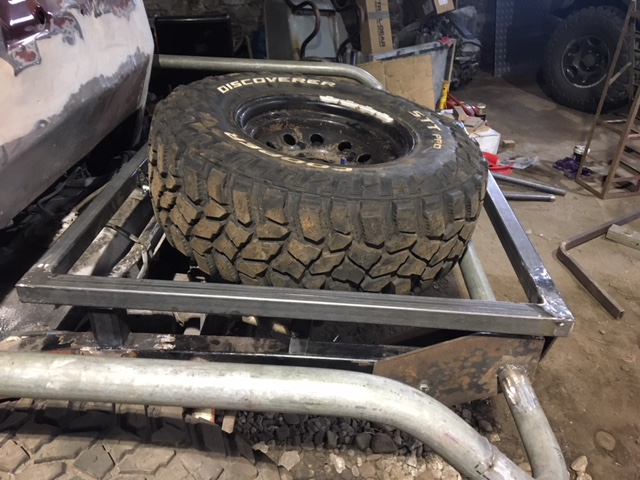

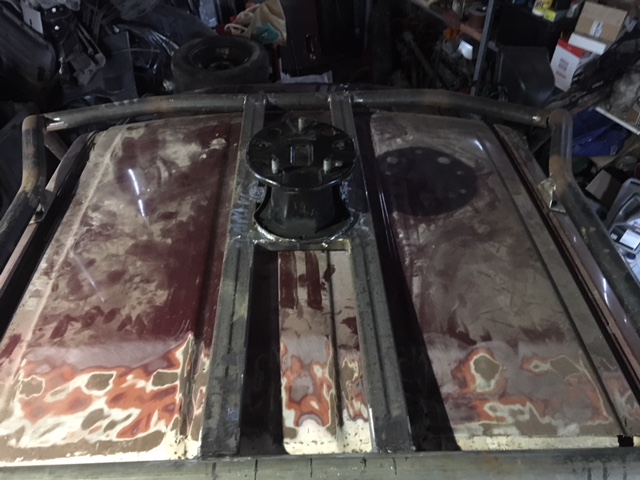

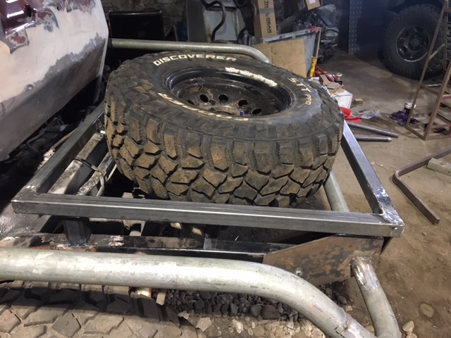

Next was to sort out a bracket for the spare wheel. After much debate I have decided to put it on the roof, so heres a nice strong bracket for it made using the old rear door bracket:

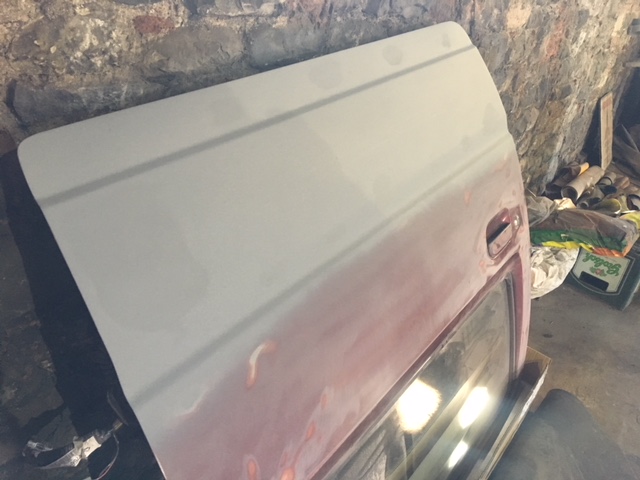

Finally I also managed to squeeze in taking the doors off and welding up all the holes from the plastics. a bit of filler and primer, they look ok now

Looks good. I like the smooth door look.
