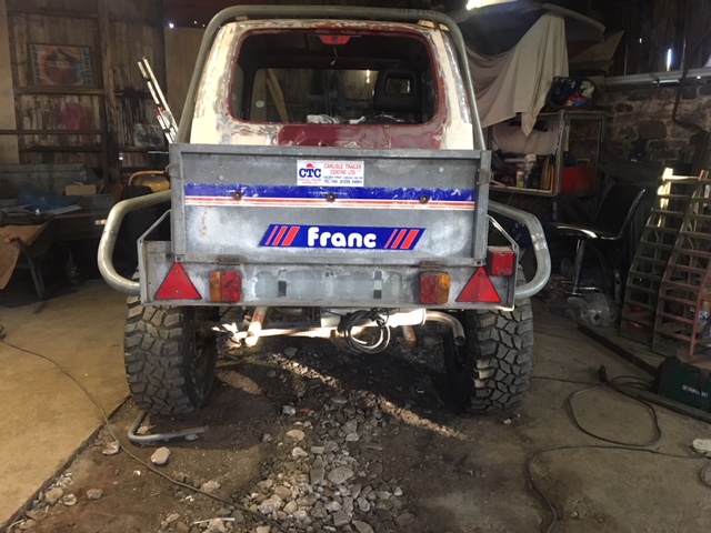

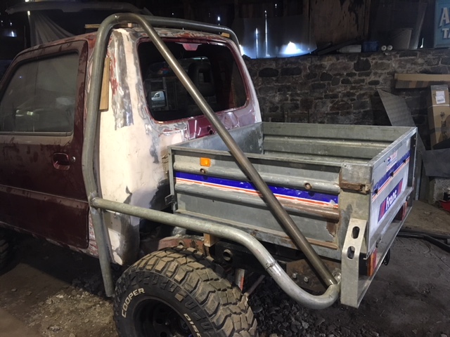

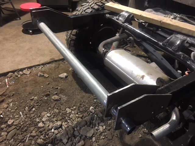

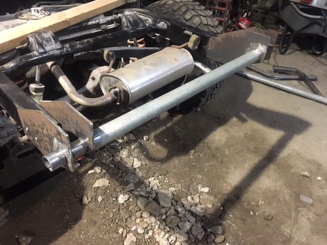

And now for the back end...

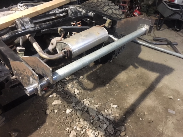

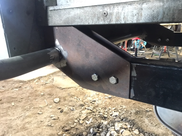

Made up some bolt-on plates and a tube to link between the chassis rails and support the trailer body...

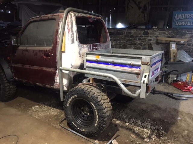

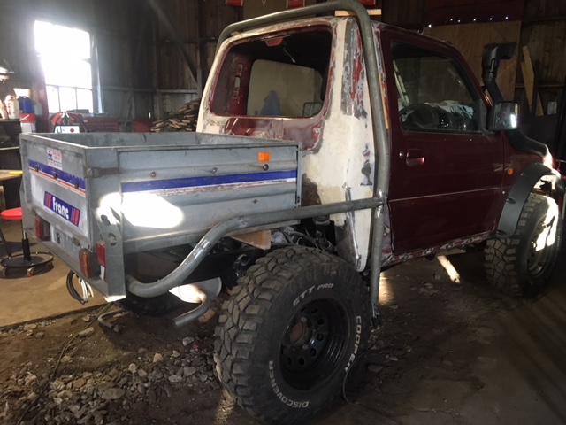

Then tried some 2 plane pipe bending. Unfortunatley the bender I have is unable to make bends close together by its design, so I did have to cut, sleeve internally and weld a section on the drop of the side bars, but its pretty good and certainly strong enough in the scaffolding pipe. The side bars weld to the roof hoop and to the rear bolt-on plates.
And the trailer body fits nice and snug on the brackets:
Decided a bit of bracing was needed so have started on some kickers from the roof down to the mounting plates.
Next will be finishing the other kicker and onto the rock-slider part of it. That will also need to be a bolt on fixing of some sort to enable the cage to be removable, but that shouldn't be too hard. Rocksliders are basically box section steel to run along the sills and have kickers back to the chassis for strength.
