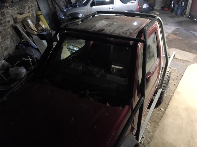

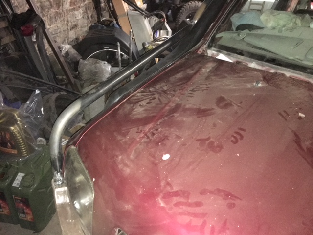

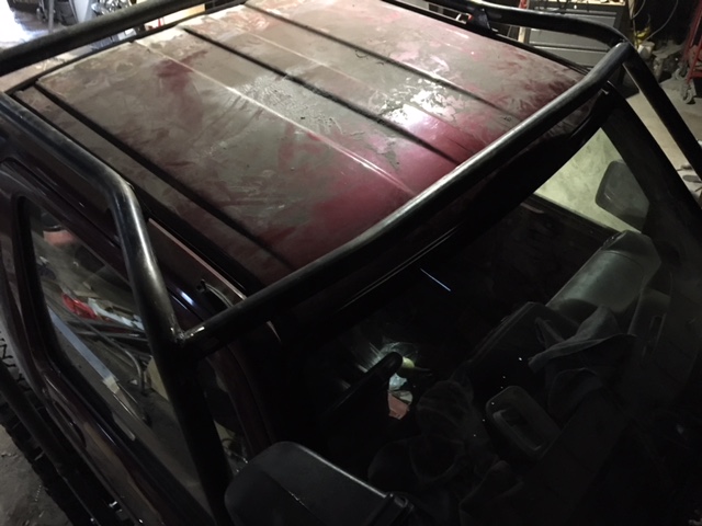

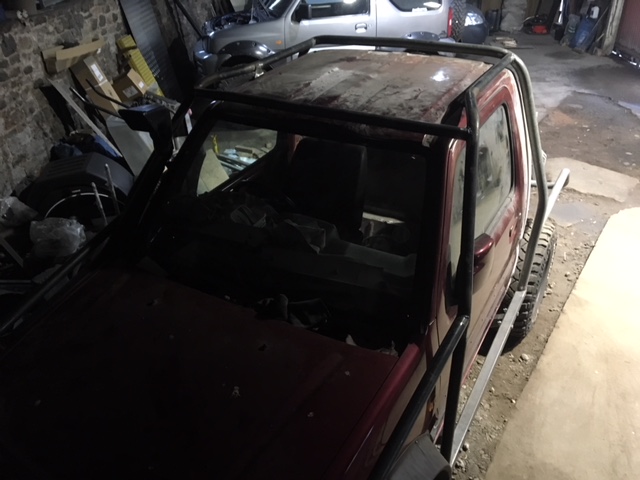

No eBay APP ID and/or Cert ID defined in Kunena configurationNo eBay APP ID and/or Cert ID defined in Kunena configurationYay! the cage is finished (bar taking off to final weld and paint).
Finished fitting the rockslider to the driver side and welded plates/outriggers to the chassis. Rocksliders bolt onto the outriggers so the cage can be removed.

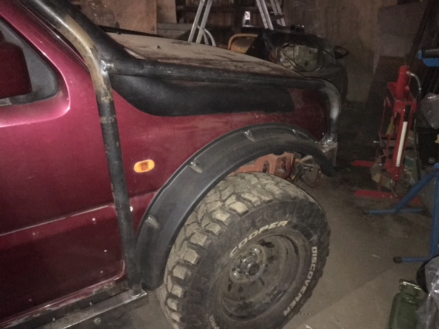

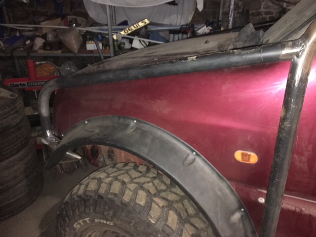

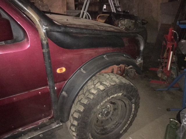

Made up another foot plate for the driver side to bolt to the roof bar bolts. Also made the bar to go above the windscreen and bars at the front wings (brush bars). The brush bars are welded to the cage, but have a bolt down plate where they meet the front bumper, again to allow the cage to be removed.
Also some of these huge wheel arches arrived this week, they will be needing a bit of trimming, but will do nicely for the back wheels:
