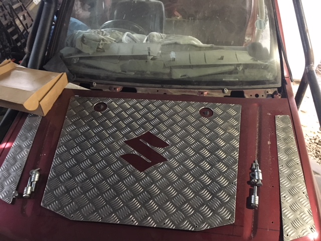

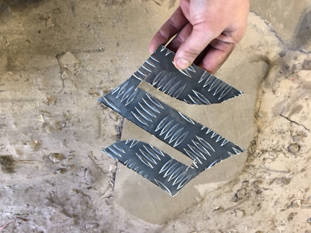

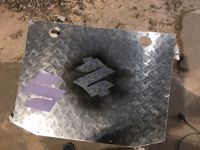

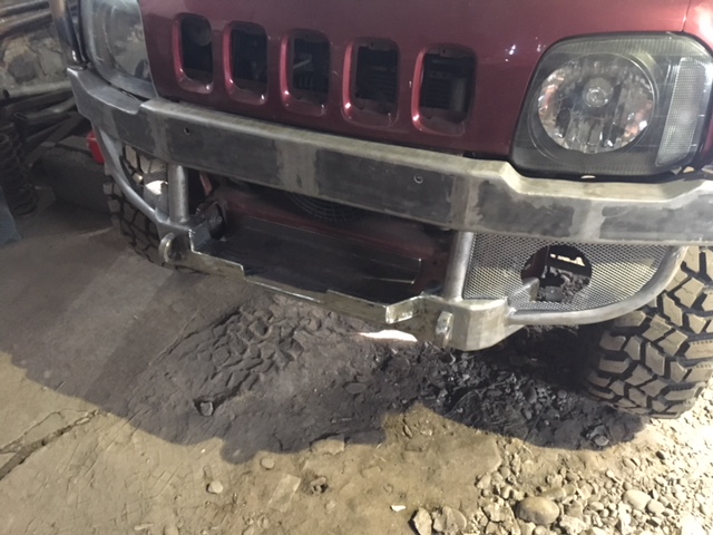

Thanks for the info on the cutting, Decided to have a go with the grinder and fairly pleased with it:
printed a S as big as i could on A4 paper, cut out and reversed. spray painted over it and cut out. trimmed up with a die grinder and hand files

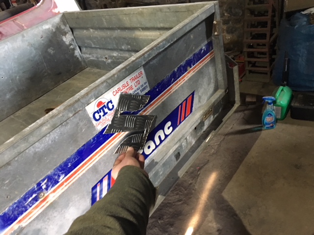

The cut out S might be some use for the back?
though its a bit rough, being the off-cut. Wouldnt be that hard to make a fresh one
Then a bit of recycling of an old winch tray to integrate into the bumper nicely:

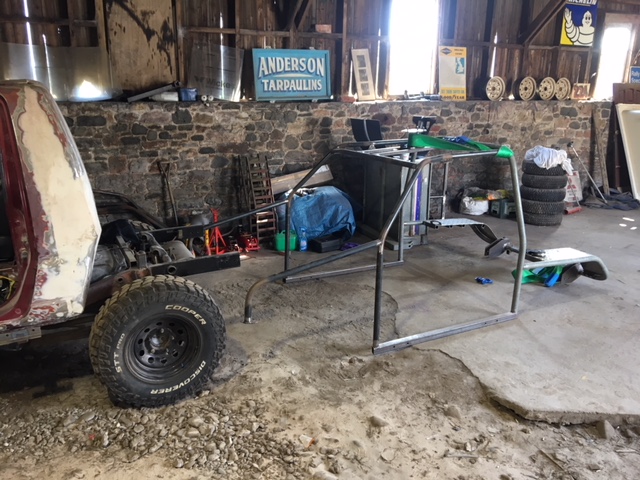

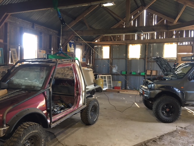

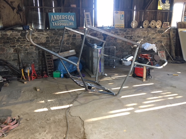

and time to remove the cage. not easy on my own, but rigged up the winch on J999MNY and put it to good use :laugh:
for welding up all the bits i couldnt reach when it was on the car. Hopefully this will be the only time its upside down :silly:
