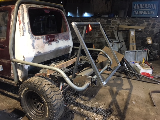

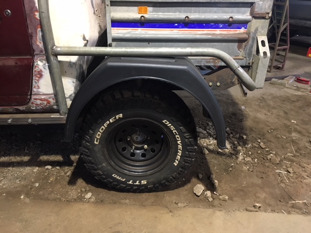

Quick trial of where the new mudflaps will sit, need some serious trimming. Far too wide, but that wont matter...
Need to get the trailer body mounted up properly before messing about with them, so...

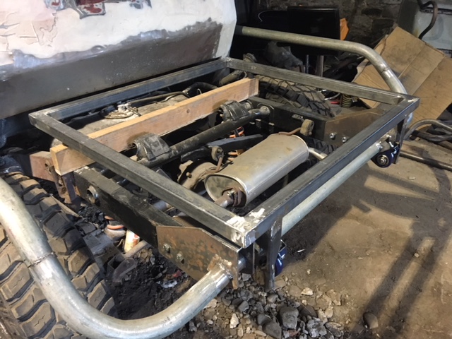

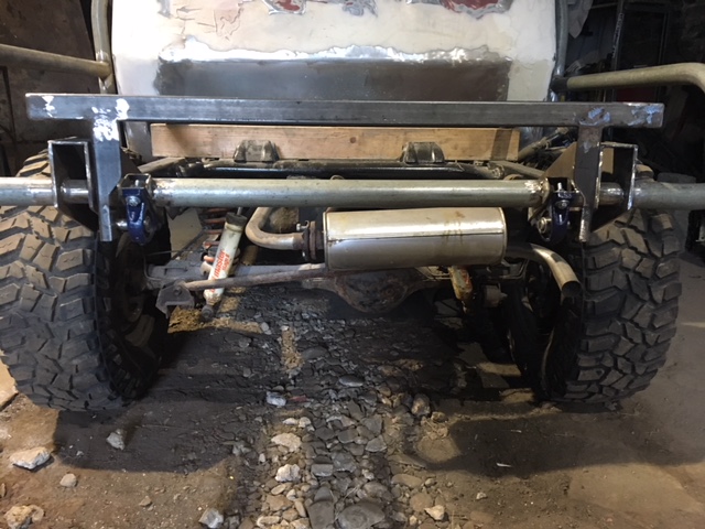

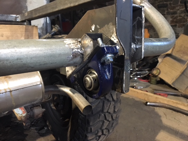

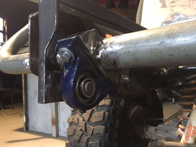

The off with the trailer body and make up a frame for it to sit on out of 40x40x2.5 box. Made some brackets for the pillow block bearings and used a weld-on gate pin for the mount into the bearing (conveniently the right size for the job)...
Next is onto making a bracket for the actuator/ram to mount to and swivel from, using measurements from the suppliers site (havent decided what size to order yet). Might even be enough room under there for a rear winch :whistle:
