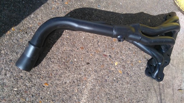

I have now found the pictured manifold at £129 which is not too rich for a gamble to see if we can get something of use....
I'm also talking to a fella in China at a reputable firm whose headers looked much more purposeful and are designed for the jimny. I might have to buy 10 systems but may well do that at a price I've been quoted for a single bespoke system in the UK. Just got to make sure I don't get my pants pulled down, which might be quite the job.

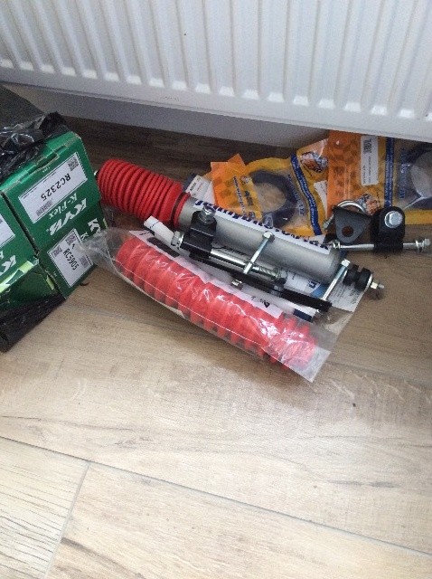

Well the KYB springs have turned up at last, I'm happy that they are made in the Czech Rep, any luck and they won't have Chinese steel in them.
I'm retired now but held welding codes for many years and have watched as the quality of steel has been poisoned by China.
These look to be of good quality and the coils on each pair (f/r) match perfectly (good repeatability in the coil cuts and coil structure are a sign of a strong process and stable steel), powder coated so finish is perfect.
Still waiting on the AVO dampers, should be here in the next few days, I also forgot extended bump stops which are now winging their way from Jimnybits.
I have found a local garage that rents ramp time for £50 a day and that includes air tools which will make it a breeze and no bad back to boot....

Good progress! Are the springs the same side to side? As standard our RHD Jimnys have a softer spring (thinner wire used in the coils) on the NSR. If both springs are the same you may find yourself suffering from Jimny lean.
8 years 8 months ago #190079
by sniper
Replied by sniper on topic Discreet but capable
Thanks busta, both rear springs appear identical so it looks like I may have to play around with spring seats if the problem arises. I'm fitting 15mm seats to start so I might drop to 5mm on that corner if needed. Not something I had considered.......
