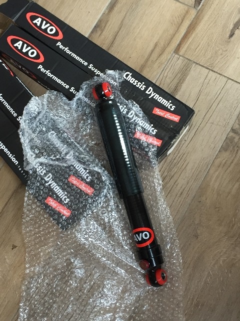

8 years 7 months ago #190957
by sniper
Replied by sniper on topic Discreet but capable
Three wheels on my wagon....... They only sent 3 dampers, a mess up on their end.
Final one delivered tomorrow, very frustrating. It's the third time I've planned to fit them.
sniper
