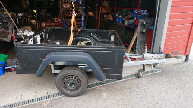

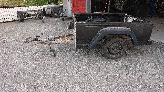

First I did a test fit to see how much had to be done to the frame and mounts. Might have to get a bodylift.
Wheels is a issue I have not solved yet as i would like to have 235's or 30" or so..
Would need 4x100 wheels with ET-30 instead of ET30.. Might have to make them myself if i cannot find them.

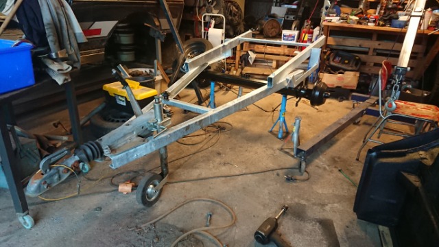

So I finished the frame rails and sent it off to be galvanized.
Got the frame back from a local galvanizing company yesterday.
today I will continue to put it toghether and find out what else is needed like dampers and wires and serivce parts.

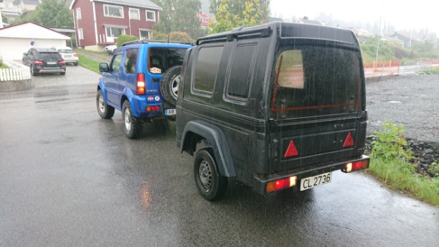

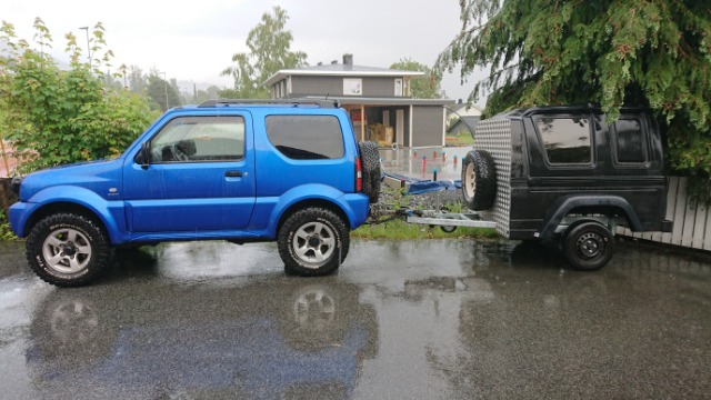

Regret cutting the tub where i did ten years ago when i started this.
Now i have been thinking more like making it into a small camping trailer.
I need 30cm more length in the front so I have been thinking of cutting another SJ to use the front or the back to finish it up better than the aluminium sheet I got now. Or I might just add a simpler extension of some sort.
I can just about sleep in it diagonally now, but 20-30cm more would be nice..

Coming along nicely. Lights done, all fully functional now. Brakes are weak. Will try to adjust them.
Next is to adjust the hardtop and seal all the leaks.
But now I had to get it out to make room for the Swift to fix a drive shaft.
Replied by yakuza on topic The SJ413 of the Yakuza (and his trailer)
