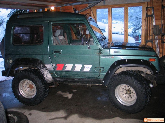

Just got this sudden urge to show my SJ from 15 years back, sorry if I allready did.
40(or 50mm bought used) OME lift springs, Volvo or Shogun or Corsa shocks (do not repeat that!) , 2" home made Body lift, home made flat belly bash plate, 8" wheels 325-65-15 BFG MT, cut out 3" of the fenders, bushwacker flares. many different G13 engines with various carbs, lastly a '92 engine still got it. Home made 4,16 :1 transfer gears. "Opel" Recaro seats.
Did the rust in the fenders, did the sills, but got kids so did not get around to do the body mount rust so got scrapped as it had too many none-approved mods. Ripped for parts, got most of it still.
