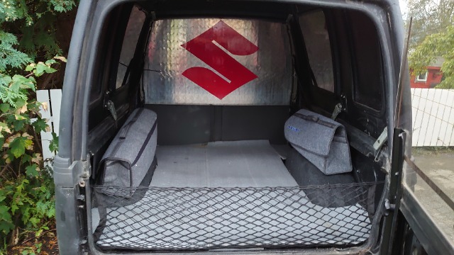

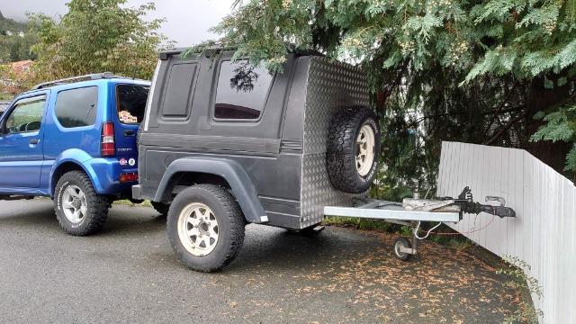

Just a few pictures and updates on the trailer build:
Interior, without the mattress. The aluminium is a great heat conductor. So been thinking of isolation on the inside there. And here and there inside. Covering the wheel wells with loudspeaker fabric helped alot
Roof hatch from an old caravan, and an ikea curtain on the rear window. Bare minimum but work ok. 10 nights in it so far.
Wheels are ok now, original SJ on adapter spacers. Got a set of 4x100 15" Steel wheels I might do som trickery to so they fit Some 235s without the spacers. Have to move the centers.
