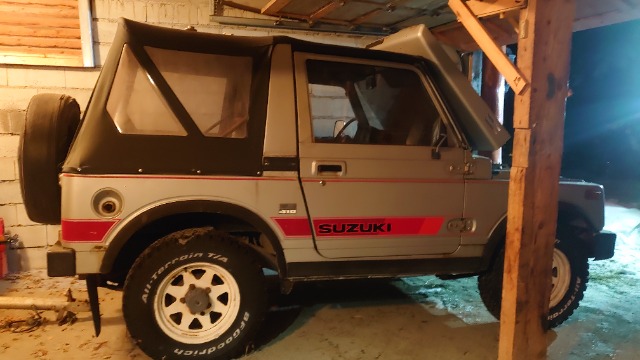

Went shopping today. 1984 SJ 410 in not too bad state. Some of the floor is fiber glass, it has alot of brown areas but was drivable when it was parked years ago. last mot it never got was 2012.
Allready found it got no spark so changed the disto from the old 410 to a SJ 413 Electronic. I messed up where the rotor was pointing so got spark now but no timing. Will fix tomorrow.
To do list: driver seat, engine service, brakes, windshield frame, tank, headlights, alternator swap to a 413 generator, do the mot, drive around for a few months, sell it.

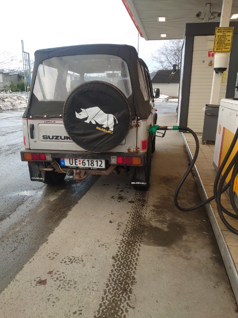

Got the left right rear wheel rolling so i could find the ignition mark on the flywheel by rolling the car a bit in third gear. i did have the distributor 180 wrong of course. Drove over to gas station to fill it up a bit. brakes are very bad but it is very short and sunday morning only me out.

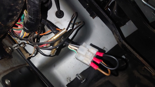

Next was the alternator and charging relay from the 410 out, and a 413 alternator in. jumped and shorted the connections to give the 413 alt ignition power and hook the dash lamp up.
This is the connector for the charging relay that I removed so i can use the 413 alternator.
White with red is the wire to the dash lamp so one jumper connected to a wire that ends up at the alternator.
Also found ignition power that is jumped and go down to the alternator. Charging 13.8V on the battery.
