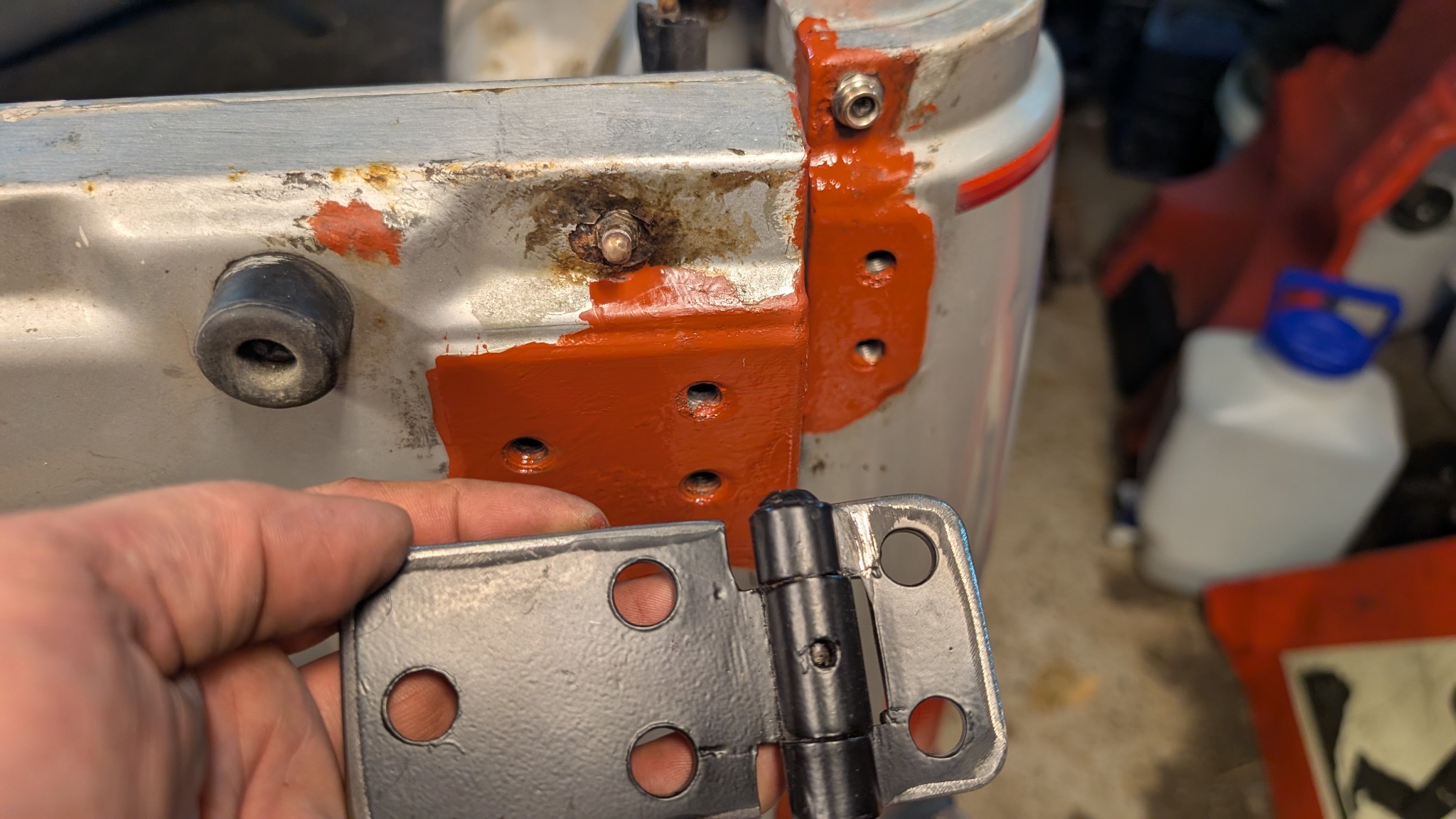

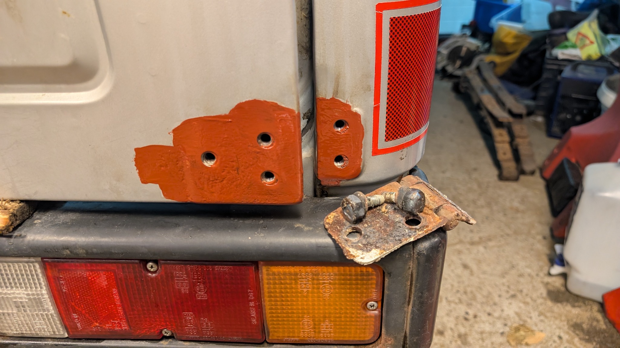

Changing the rear door himges tonight. Or most likely tomorrow, have to let the paint dry before putting the new ones on.
Welded nuts on the stuck bolts to loosen, flap disc the rust mostly off, acid something on for a few minutes, wash, dry, paint.
Not pretty but I like usable way better.
Looking forward to get rid off the constant noise of the loose old hinges.
Replied by yakuza on topic The SJ413, SJ410 and SJ510/2 trailer of the Yakuza
