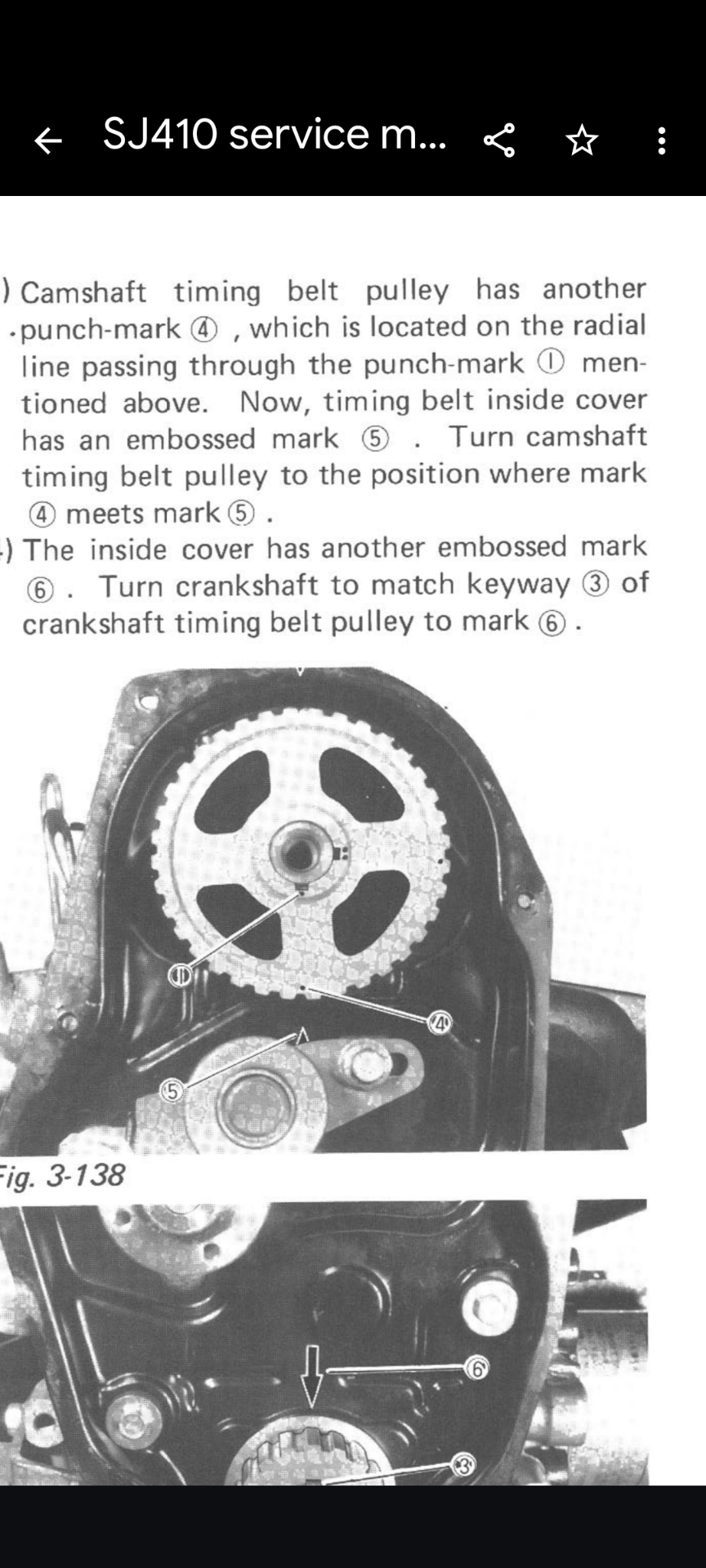

Took the head out to swap the head gasket and other seals to stop the oil from reaching the floor.
The engine is the F10a from 1984. Got into issues when putting it back together as i did not take pictures during dismantling.
At first start up there was a bang so loud my ears was ringing.
First thought was the distributor was 180 off, but after checking and another try with an even larger bang,
I found the service manual had two columns and a two step instruction for the timing belt.
I only got to read the first step as there where so many letters and words and I was too confident in my abilities.
So step two in the service manaual below where it says to turn the cam 180 before putting the belt back in.
Had the head cover off to verify with the valves visually too.
With the cam in its correct 180 position it started just fine.
New oil, filter, NGK spark plugs, and yellow coolant.
Very rusty inside the engine block cooling orifice so most likely been stored for the twelve years it sat with bad coolant.
The blue coolant that was in it actually loose its rust prevention after two years "they" say.
Green or red is better, so i am trying the yellow now after a flush and rinse of the system.

Cam timing wheel

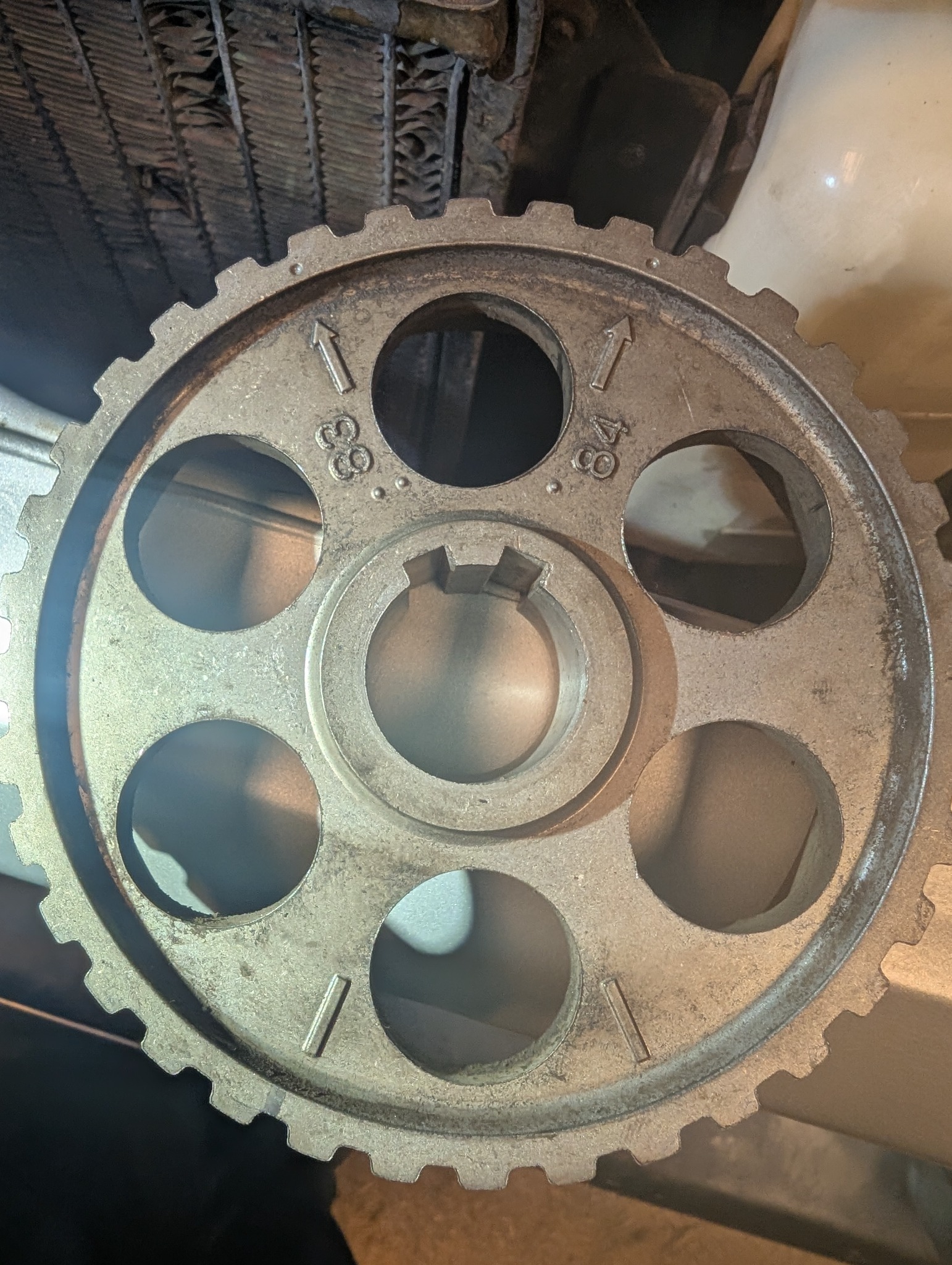

Next issue was the timing wheel with two sets of markings.
Found that the 83 and 84 markings are the number of lobes on the timing belt.
My timing belt was the 84. So the number on the timing wheel is the number of teeth on the belt.

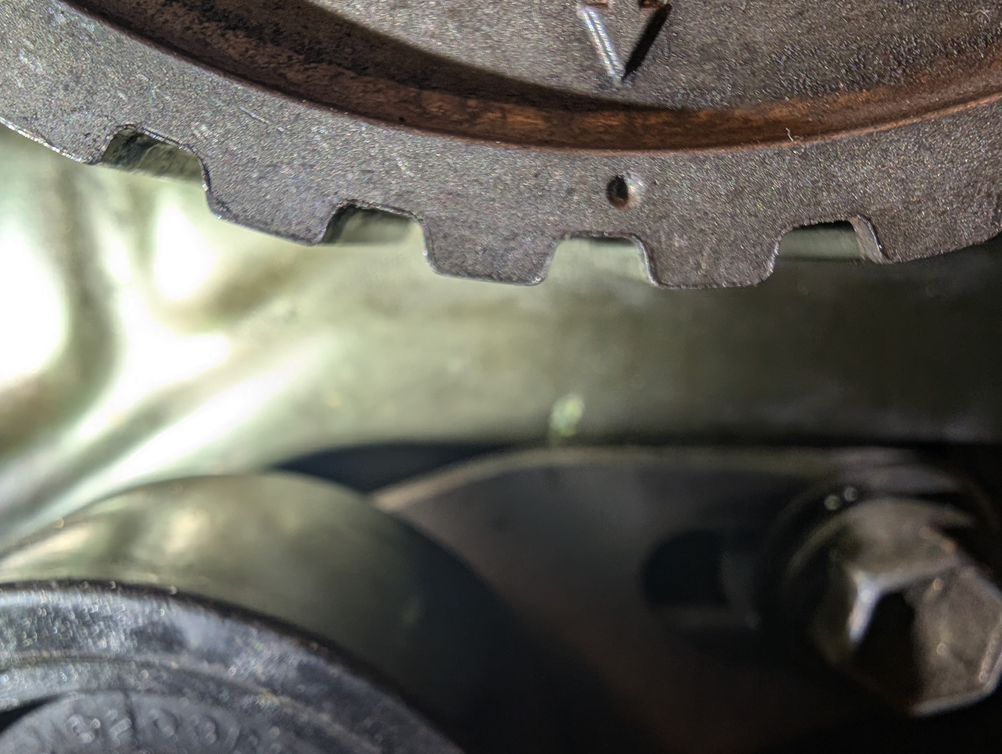

top mark:
The actual timing mark is on the timing belt housing behind the belt adjuster.
impossible to see at first glance with the radiator still in the car and behind dirt and grime.
The point mark on the wheel and key on the shaft is to point down and not towards the top.
There is also a mark on the top wich correspond with the line on the timing wheel and not the point.

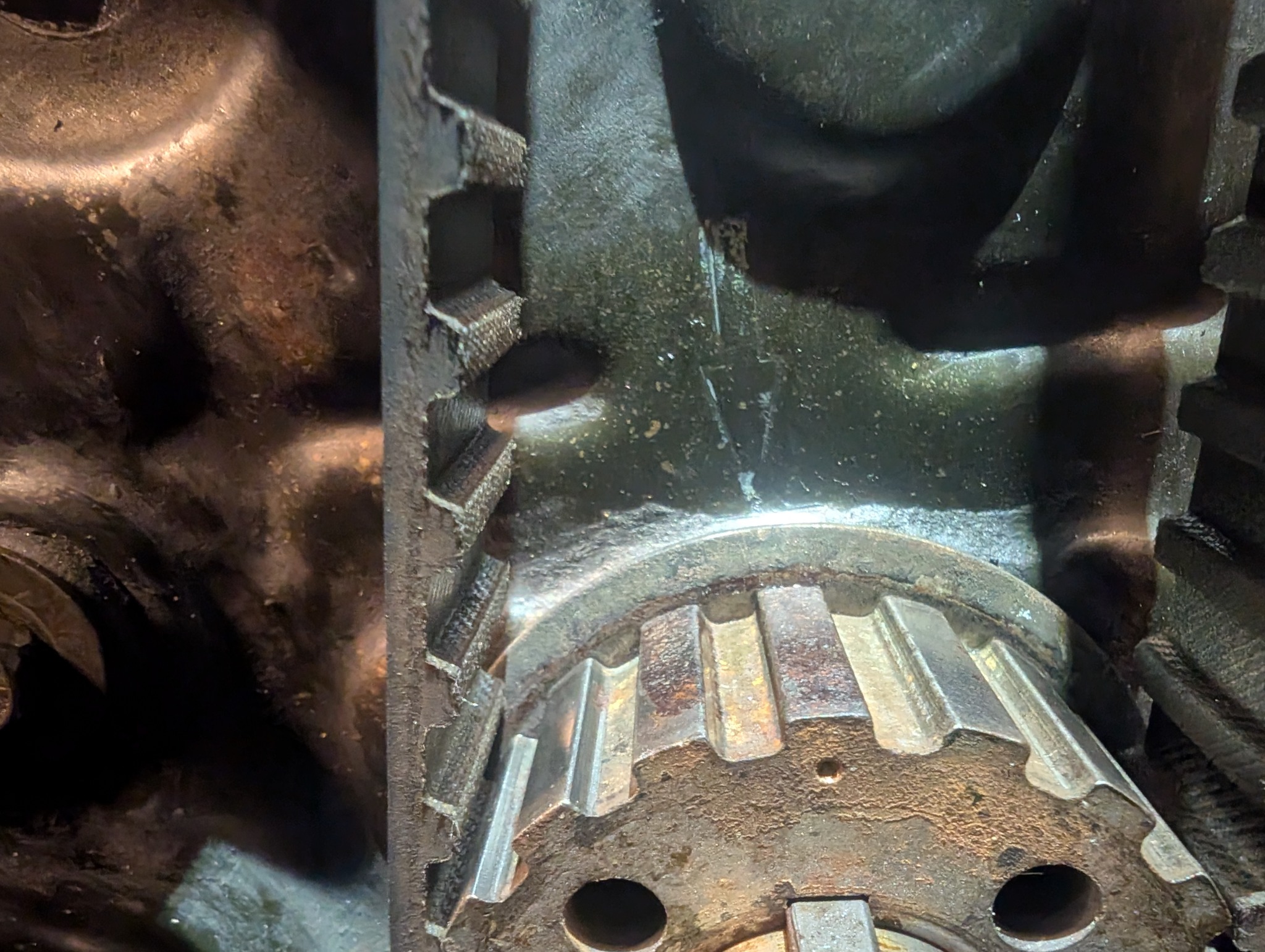

Bottom mark:
The crankshaft mark is more straight forward and also corresponds with the timing mark on the flywheel.
Hoping this post will show up on google for anyone having the same issues, i might add key words in here for later.

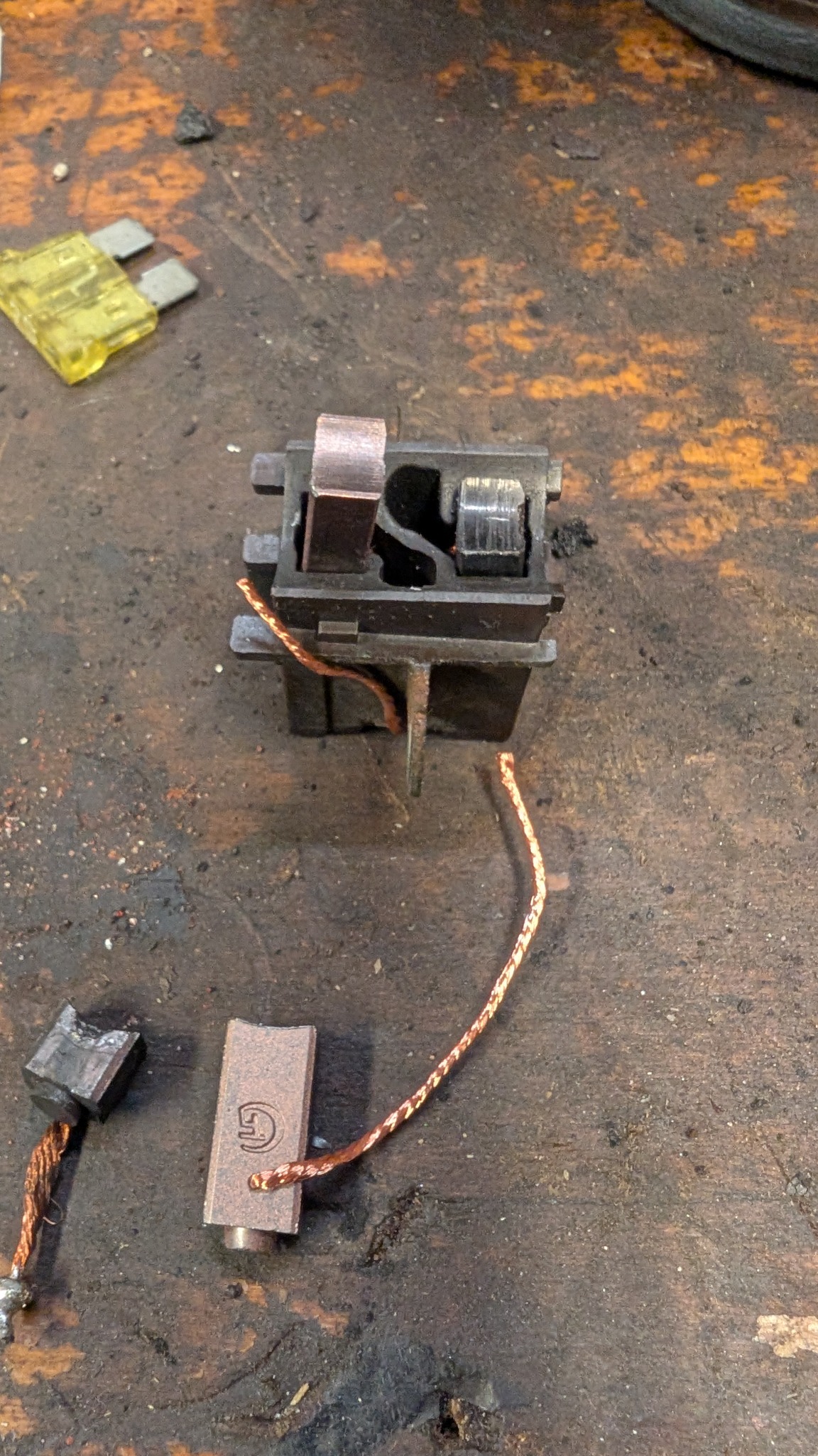

A few weeks back I changed the head gasket again. The head bolts felt loose so new better quality gasket, cleaning and proper torqued, so hoping it will last longer now.
After a successful start up there was no charging though.
So I found another used SJ413 alternator in the back of the garage, marked "bad brushes". Ordered new ones off ebay and today I got to change them.
Remove alternator from the car.
Three nuts on the back on the grey cover to take off, and loosen the positive terminal inner nut.
Remove grey cover. Loosen the brush assembly shown below wo rubber cover, two small screws.
Lift assy out, nothing will fly off usually.

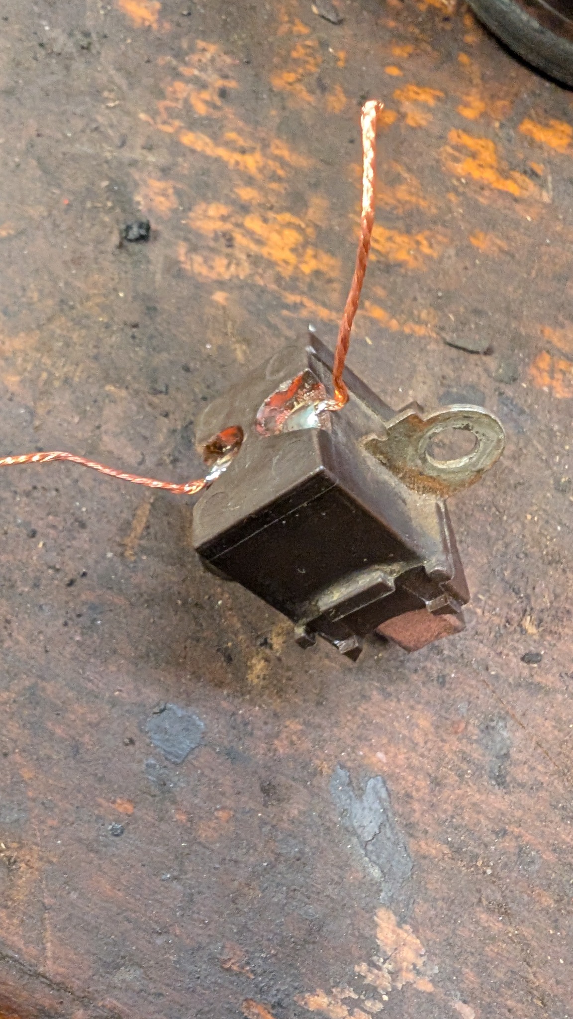

Solder the back of two terminals on the assembly, now they will come out so take care of the spring.
To loosen old solder a drop of new solder will help the heat get inside the old solder.
Open hole in the terminal with the solder iron, insert new brush with spring.
Adjust lenght approx as it was before abd solder new brush wire to the terminal.
Cut off excess wire, put everything back together.
Used brush on the left and a new one on the right.
Soldered new brushes.
14.4V charging now. But the roof is off and it is 10 degrees and raining.
