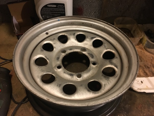

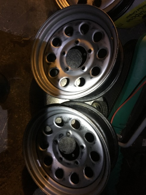

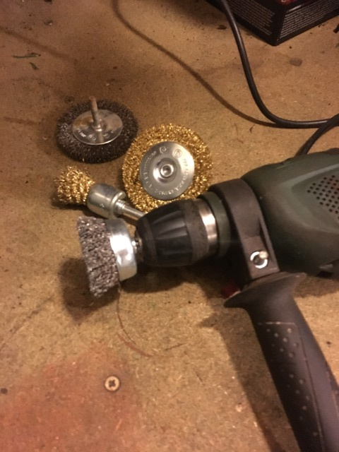

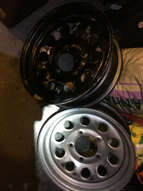

Thankfully the wheels bar one were in good condition. So after about an hour with a drill with some wire brushes and the wheels are ready for some primer and paint tomorrow.

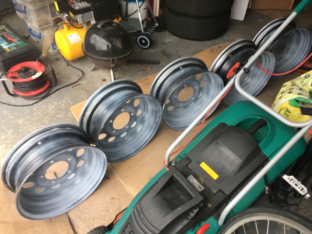

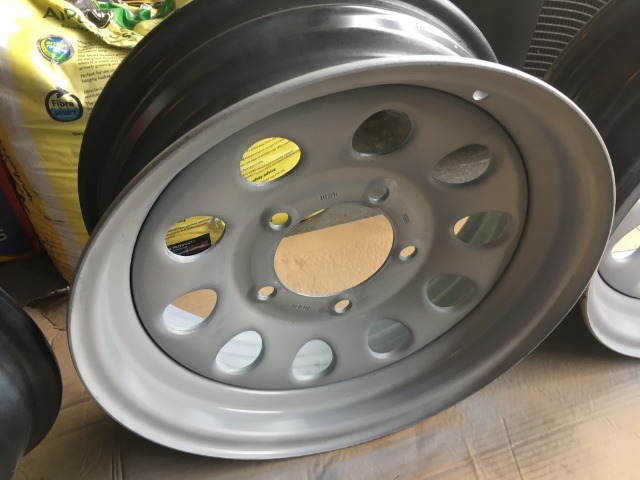

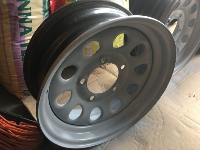

Backs after 1 coat of acid etching primer
Fronts after two coats of acid etching primer

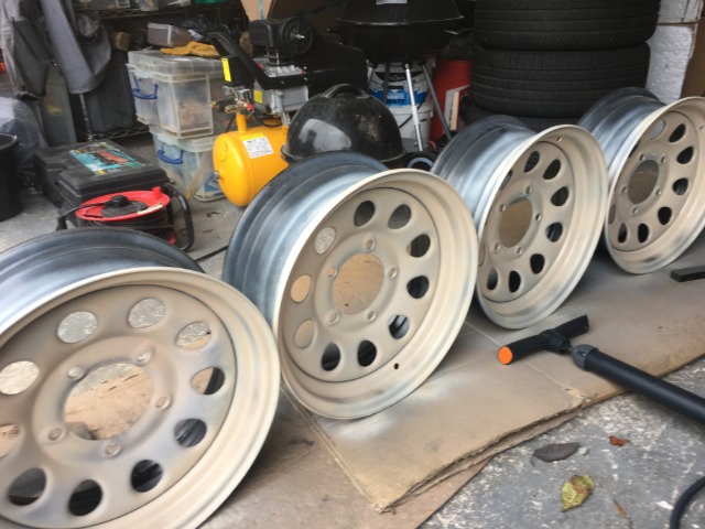

After first coat of ivory

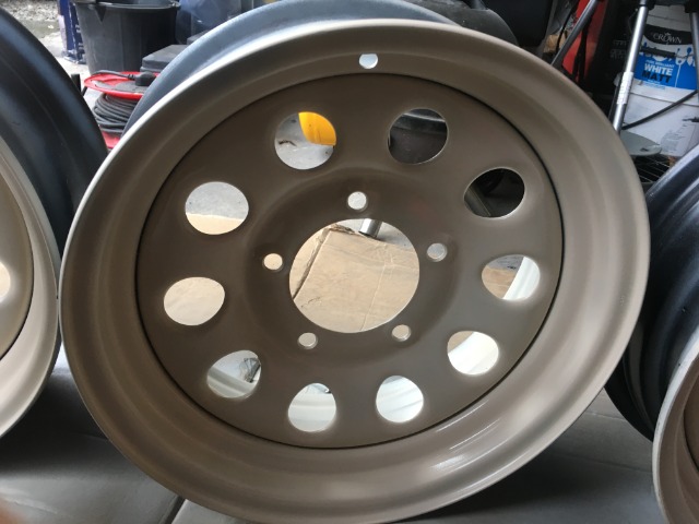

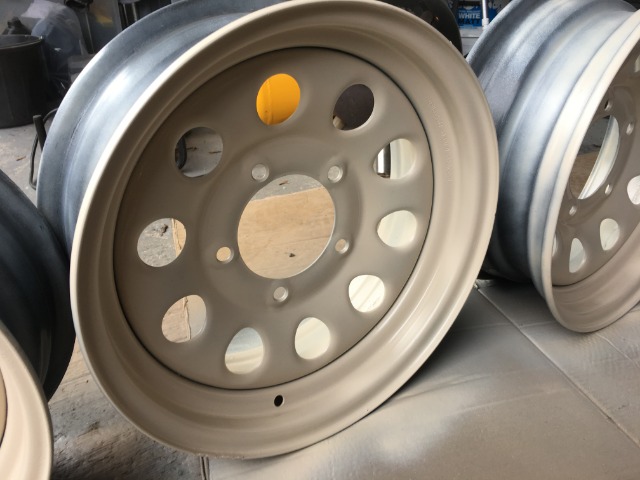

After 2 coats of Ivory
1 more coat to go then I'll do a clear coat tomorrow, ready for tyres on Monday.
