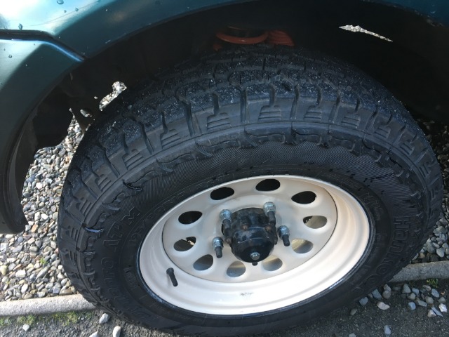

A couple of pics - wheel, new tyre and bolt through the hub to fix the hub. New shock and spring in the background.

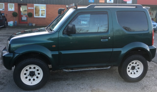

Outside my pal's garage after doing the suspension.
Still got the clunk on the back left. Radius arm bushes need doing and I wonder if the axle mount holes are a little oval.
