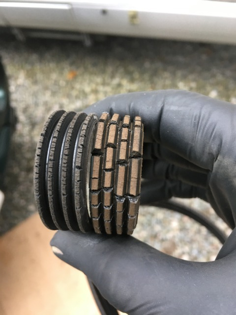

02 Jan 2019 17:40 - 02 Jan 2019 21:16 #199906
by adrianr
About Wee Jimmy : www.bigjimny.com/index.php/forum/8-my-ji...-first-jimny?start=0
Replied by adrianr on topic Just purchased my first Jimny
Extended diff breathers - they now terminate inside the top of the snorkel. The breather on the top of the transfer case is tricky.
Replaced oils in front and back axles, transfer case and gearbox.
Went to fit my new all terrains - however, the 8.5 inch alloys on it now are too wide for the 195 all terrains. So I'll look for a set of steelies or alloys.
Did the bolt through the bub mod so now we have 4wd. Did a quick 10 mile run in 2wd - feels to drive no differently than if the front hubs were freewheeling.
