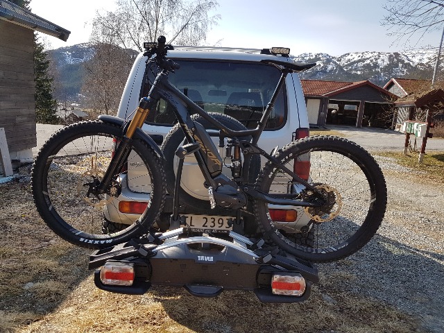

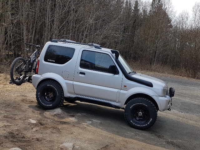

Finally spring time, back on MT's after some months on stud tires.
Mountainbike season has started as well, and i can't stop laughing at the little jimny with the huge bike/bikerack :laugh:
