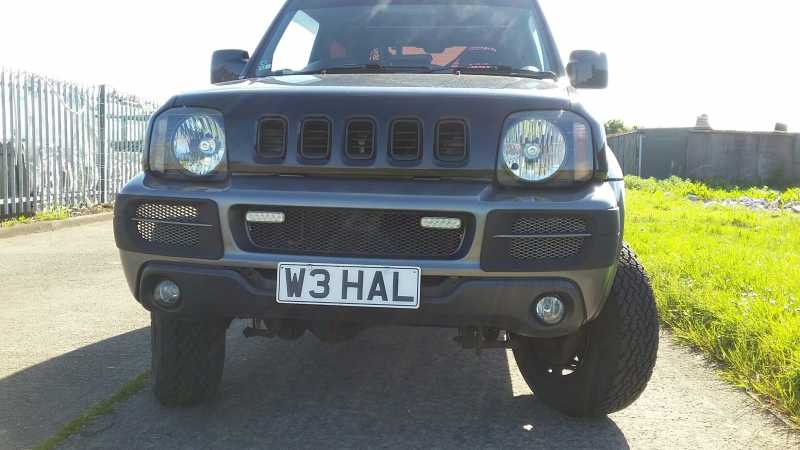

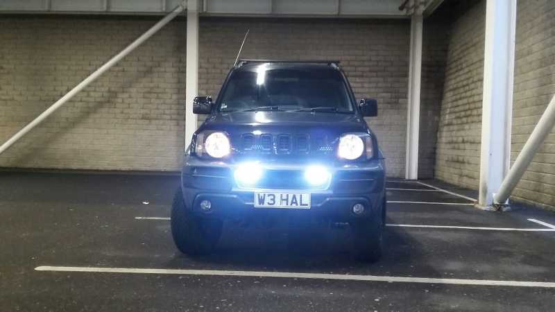

just a little update as it's been a while, DRLs now fitted and wired up
Ring Daytime LED Styling Lights - Diamond Ice
just got them from Halfrauds during a flash sale
connected them to the [strike]tea[/strike] side lights so I can control when they're on/off
(connect one wire to sidelight red/yellow and the other to an earth point - simples)
pretty pleased with them, they are bright and quite neat.

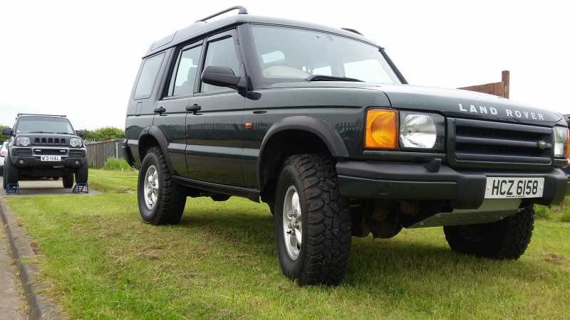

11 Jun 2016 14:40 #168350
by Halford
had a visit from a man in his reasonably priced TD5 today
and he made me an offer I couldn't refuse
spot the difference
spot the difference
