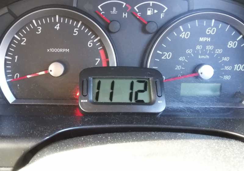

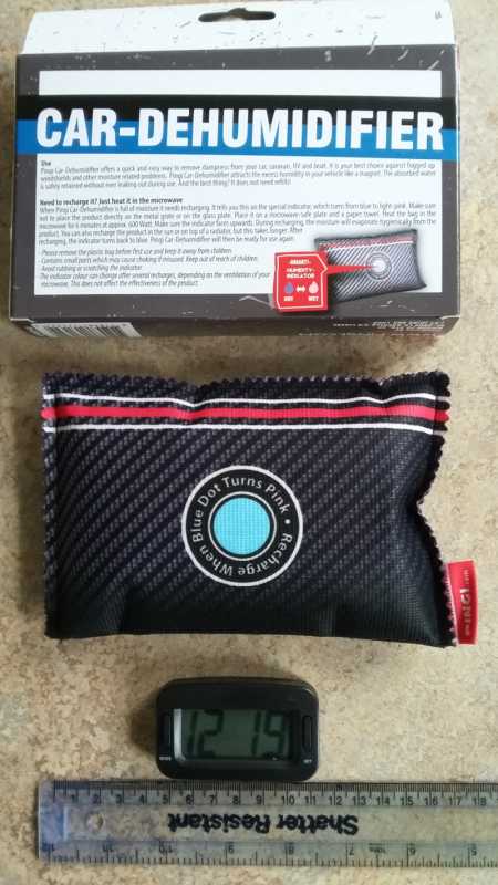

haven't done much to the Jimny recently,
so just had to do something :laugh:
bought these
really happy with the clock ( (from CPC if interested )
bought these

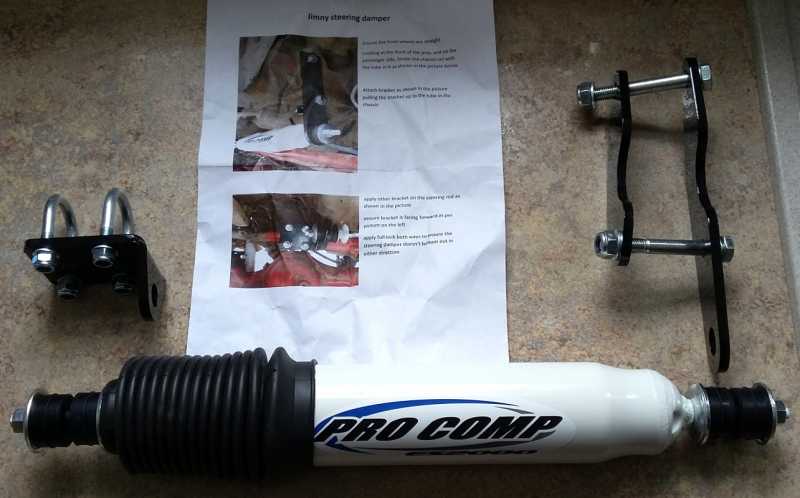

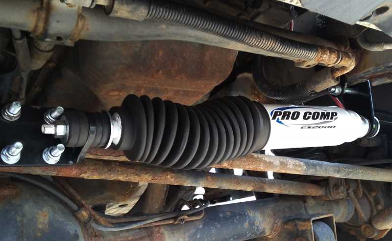

A steering damper fitted ........
For a few years now I'd been thinking of getting a steering damper, but the general populace conveyed the opinion that there wasn't much to be gained in fitting a steering damper to a mainly road based Jimny, hence, it kept slipping back on my to-do-list as the Bank of Jimny isn't a bottomless pit :whistle:
So I've finally taken the plunge and ordered a chassis mounted kit from Jimnybits
I was well impressed with the solid quality of the fitting kit and after a visit by "Gaz in his reasonably priced Rover" (his Jimny is up for sale
) .... on went the damper
:woohoo:
It has transformed the ON-ROAD stability and ride of the Jimny
The steering slackness / lightness / vagueness has gone, don't get me wrong it doesn't make steering hard work, it now feels like a normal cars' steering does, corners are smooth and controlled, straight lines are straight, road surfaces are softer, no more pothole or uneven surface crashy-ness - you really do have to try one to comprehend the difference - and it's not masking any faults on my truck as it's pretty well sorted.
So am I impressed - hell yeah - if you've been sitting on the fence wondering whether to get a steering damper - do it it's well worth it.

Excellent addition Halford. As you say it does remove the vagueness and it just calms it down on bad road surfaces.
I bet your jimny feels amazing to drive on the road with wider wheels, firmer suspension and the damper.
