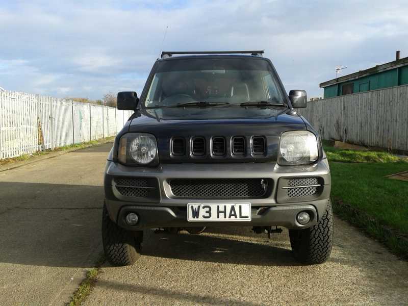

20 Nov 2015 18:03 - 20 Nov 2015 18:08 #156733 by Halford
Felt a bit wonky today :sick:
So got the tape measure out
Measured from top of wheel arch to road (tyres inflated on level ground)
NS-Front 85.0 cm
OS-Front 83.5 cm
NS-Rear 85.5 cm
OS-Rear 84.0 cm
NS to door handle top 110.5 cm
OS to door handle top 110.0 cm
Bearing in mind its got new shocks and springs +2"
No castor correction
Whats going on ?
:huh:
looks ok
