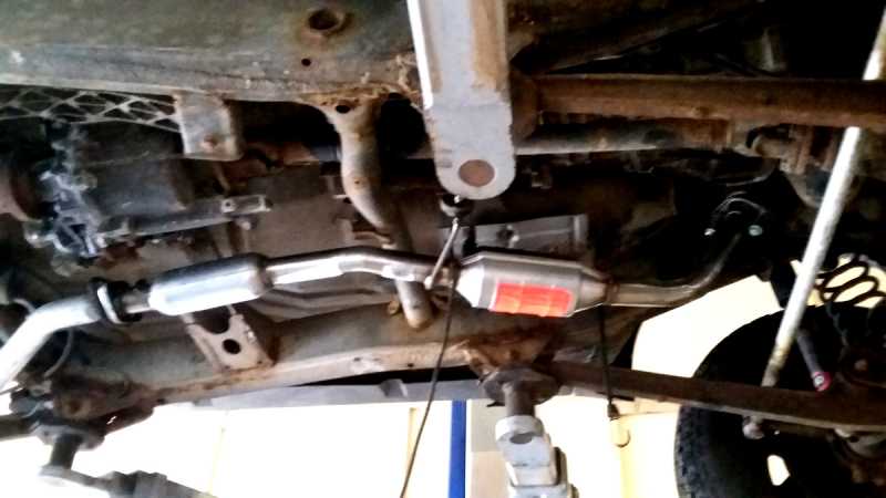

30 Mar 2016 17:06 #164654
Replied by Daniel30 on topic Halfords Dog-Taxi
Shiney!!!!!!!!!!!! :blink:
Where did you get It from Halford ? that's on my to do list does it feel good quality ish?
- Posts: 2318
- Thank you received: 360
30 Mar 2016 18:15 #164658
by Halford
Just from the local motor factors, complete with a fitting kit, new bolts and crush joints.
Had to use the old crush joints (roughed them up) as the new ones were slightly bigger, may have fit with a bit of work.
The old hot exhaust was popped off and into a vice so the lamba sensor nut slackened easier
Needed a flame on the hanger for it to bend and fit properly,
£120 fitted (£80 - £90 parts) maybe slightly cheaper on tinterBay, but need to get right one and decent quality
Easy job but well worth £30 to have a big lad do it on a ramp with heat to hand, thanks Gaz
