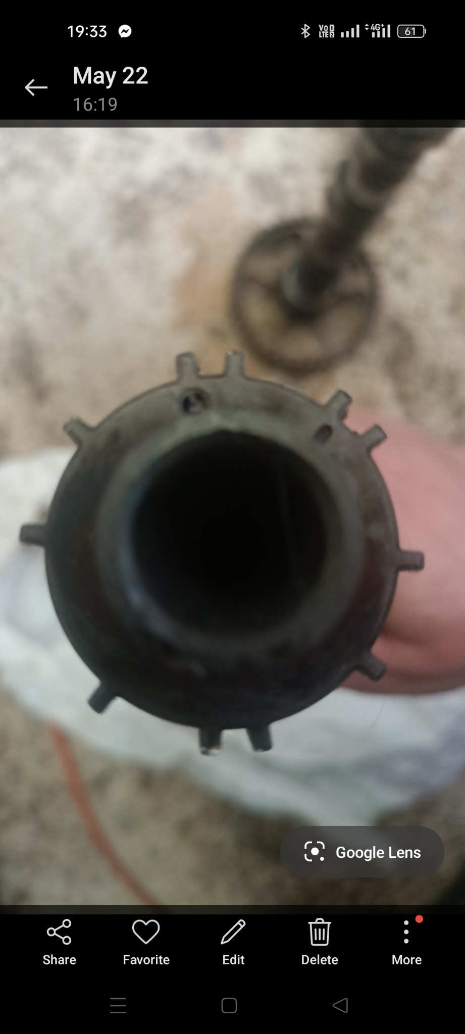

02 Jun 2025 05:50 - 02 Jun 2025 13:10 #260696
Replied by yakuza on topic Engine not starting
this is a G13.
most likely the wrong timing cam ring on the cam shaft or it is placed at the wrong timing.
there are different numbers of signaling tabs on the timing ring on different engines.
Can be moved over from your old head if it did not follow the old cam shaft over?
Pry it off the old and tap it back on the new cam shaft. Must be in the correct position but for some reason it is not so difficult to get it placed correctly, I done it a few times.
edit: usually only the later m16 has the crank sensor.
Edit2: It seems i have too little knowledge of the G13 engine in the spanish cab versions so little or nothing of the above applies to this problem..
Last edit: 02 Jun 2025 13:10 by yakuza.

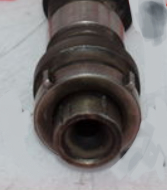

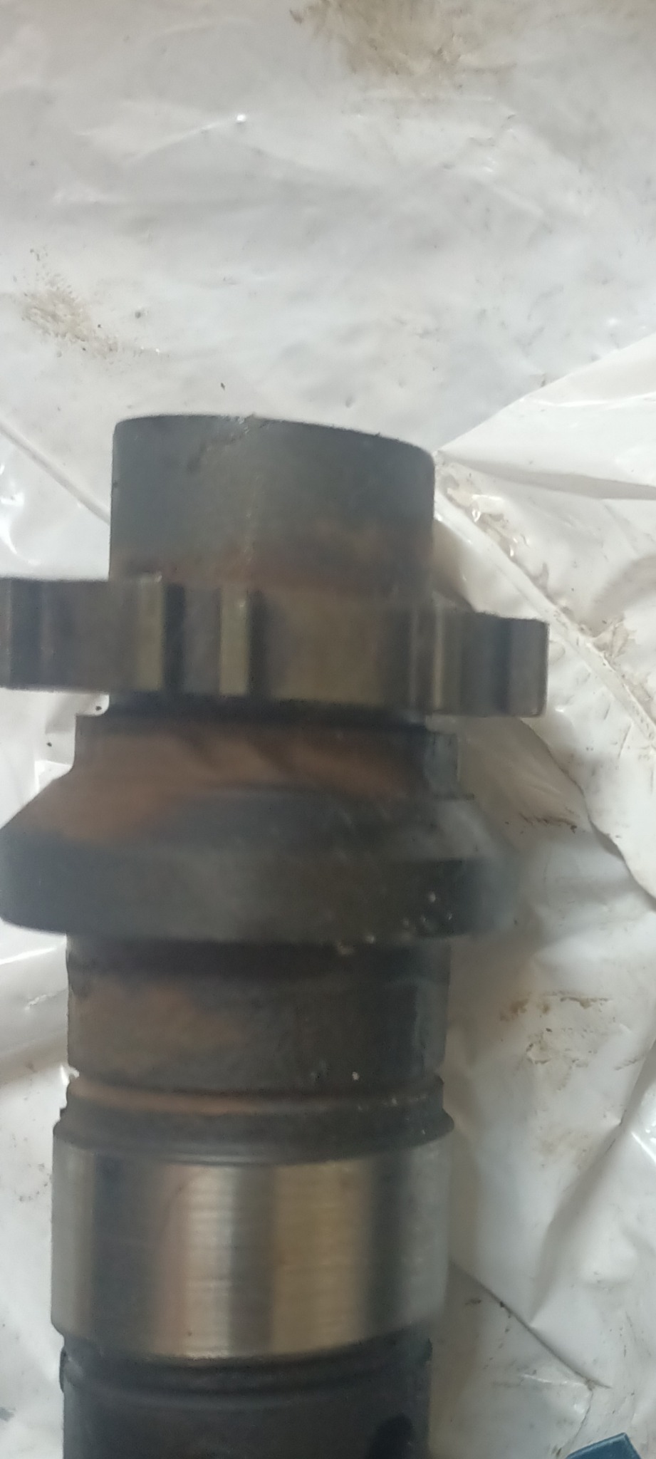

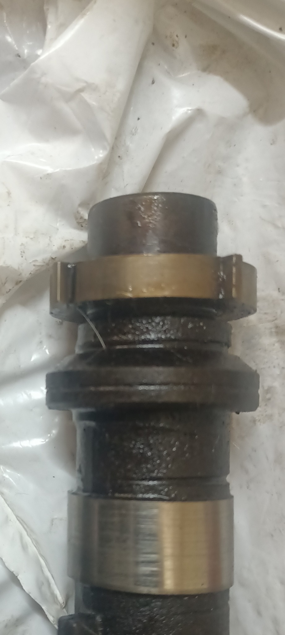

02 Jun 2025 12:09 - 02 Jun 2025 12:15 #260698
by Ovidium
Replied by Ovidium on topic Engine not starting
It is the old, original camshaft installed
It has no removable ring, just 2 lobes.
The camshaft for engine variant without crankshaft sensor looks different
But I cannot use that in my engine with crankshaft sensor.
Timing is set, marks are aligned
As you can see, I have both sensors, CKP and CMP
This engine variant was used on European soft top Jimny.
Last edit: 02 Jun 2025 12:15 by Ovidium.

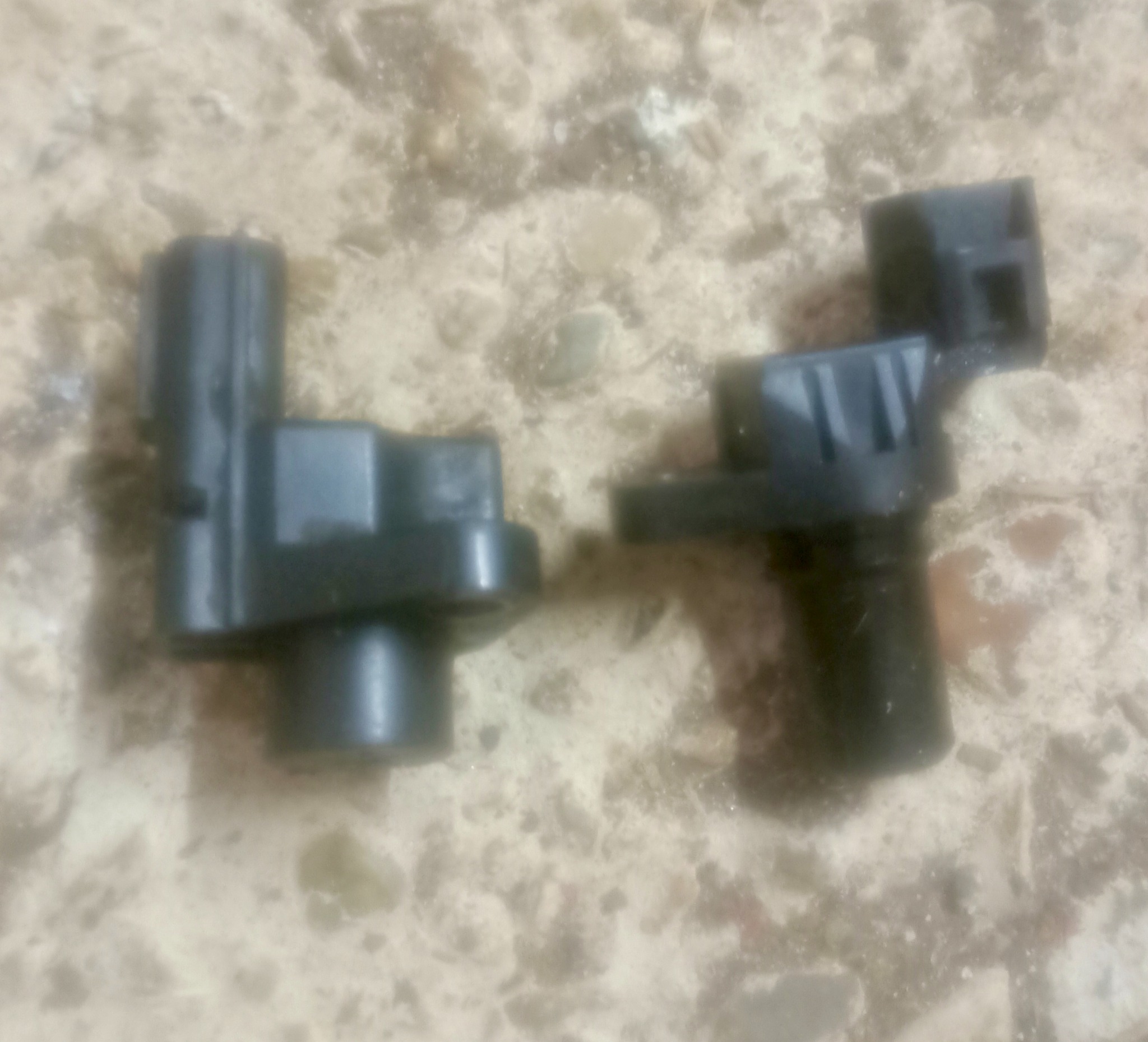

Was the cam position sensor in the replacement head the same as your old head?
I wonder if the diameter of the two timing wheels on the end of the camshaft are the same and sit in the same place?
If there is a difference in gap between cpk and timing ring between the two heads you might not be getting a good signal and this would cause the the issue with the injectors?
02 Jun 2025 12:41 - 02 Jun 2025 13:11 #260700
by Ovidium
Yes, the same sensor. I replaced it too but no change.
So you're saying to compare the sensor case to be sure it fits in same position at same gap?
LE: is the old, original casing installed. New cylinder head came without it.
Last edit: 02 Jun 2025 13:11 by Ovidium.
