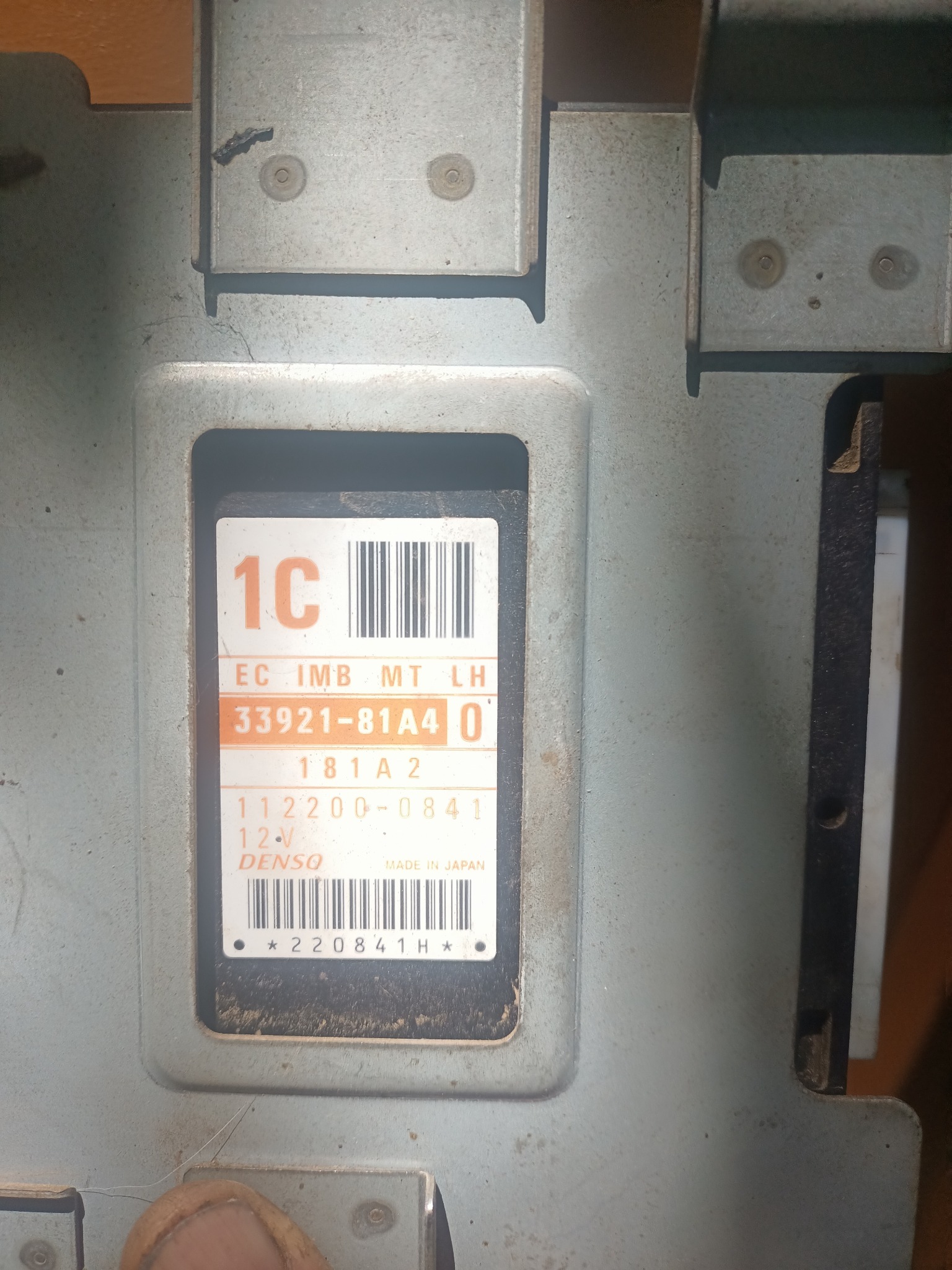

ECU:
Brand: DensoSuzuki code: 33921-81A4Denso code: 112200-0841
Visually inspected: no burnt components, smoke traces, corrosion or oxidation, neither on the PCB nor in the connectors.

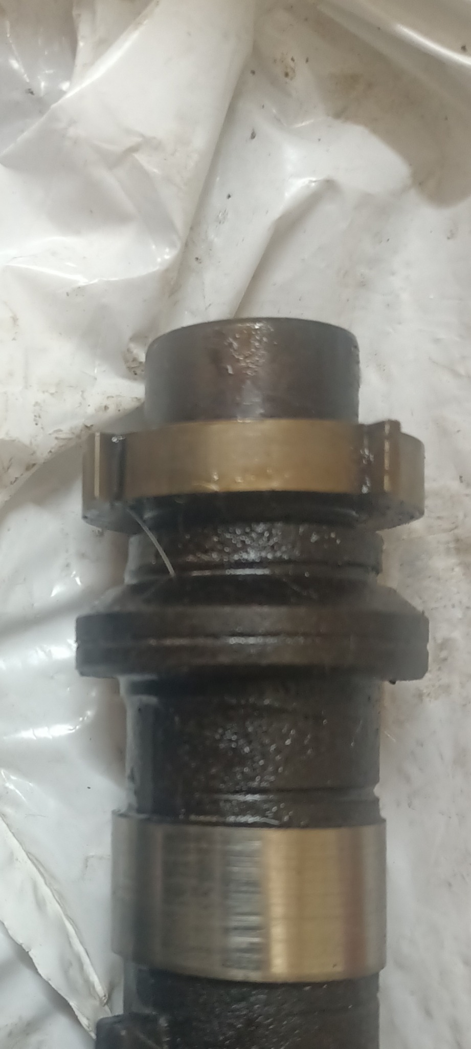

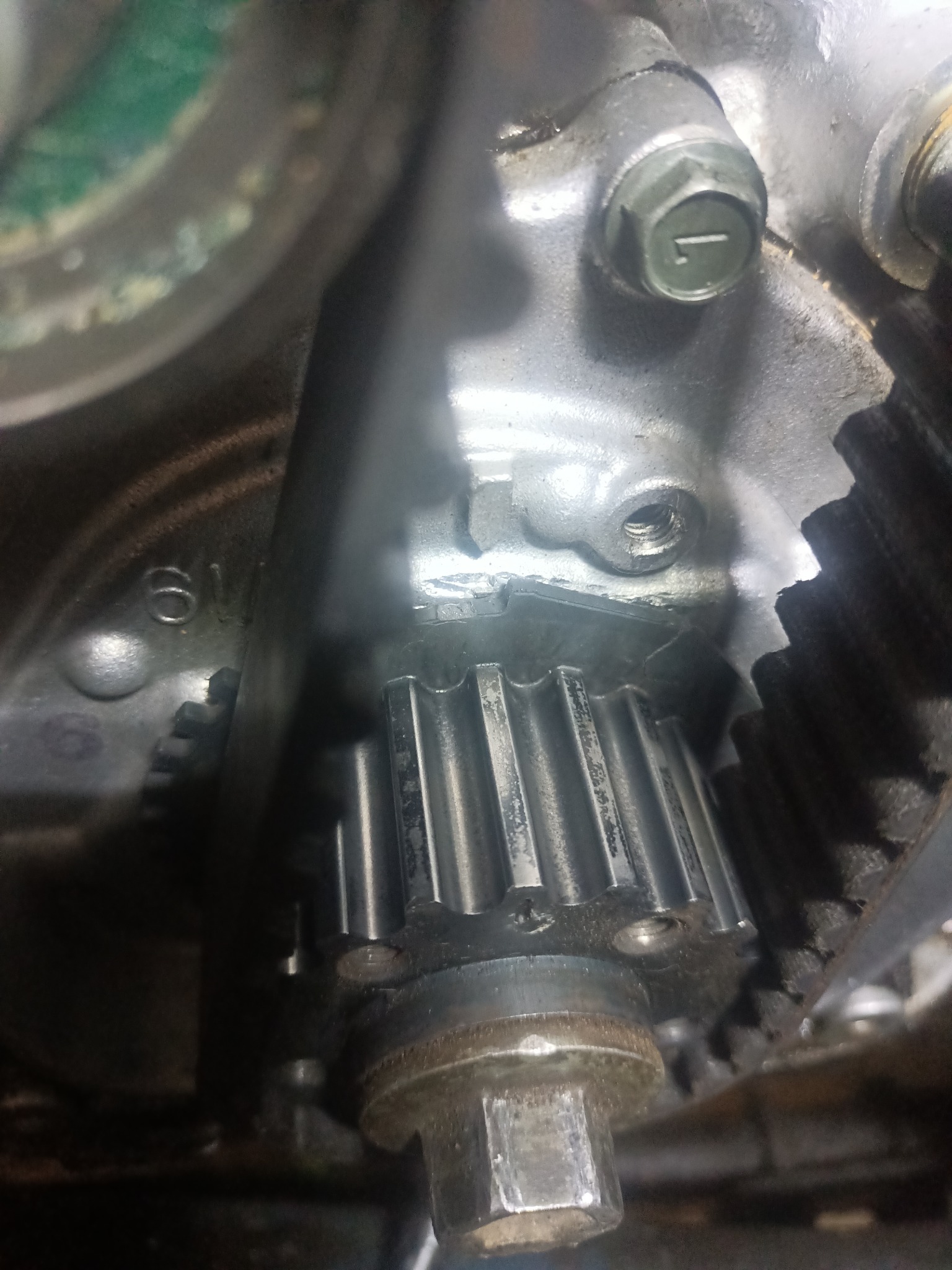

- Replaced cracked cylinder head with a reconditioned one.
The replacement head came with a different camshaft trigger wheel, so the original camshaft was reused.
Original:
New one:
