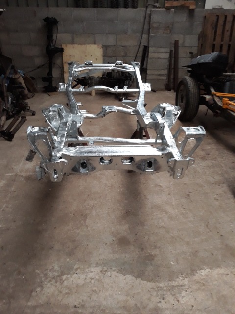

A hundred kilos of zinc on a chassis!
I find that a bit hard to believe, if it were 1mm thick, that would be 14 sq metres coverage, You sure it was 100kg, not 10? or have they filled it solid with zinc?
You will have the car overweight if you carry 4 people with 100kg extra weight on the chassis

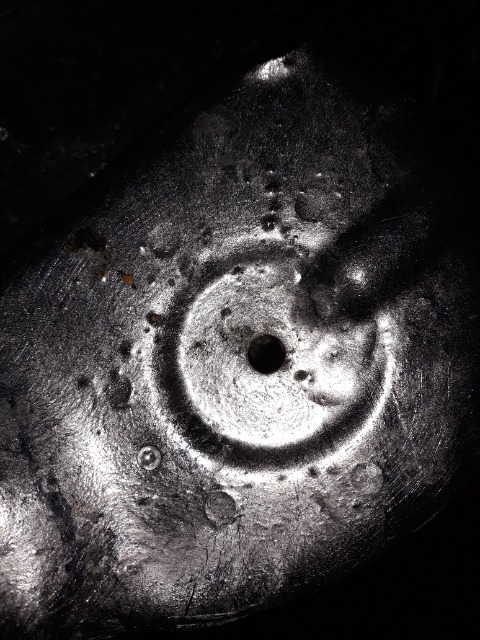

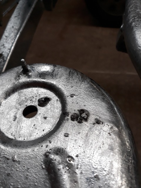

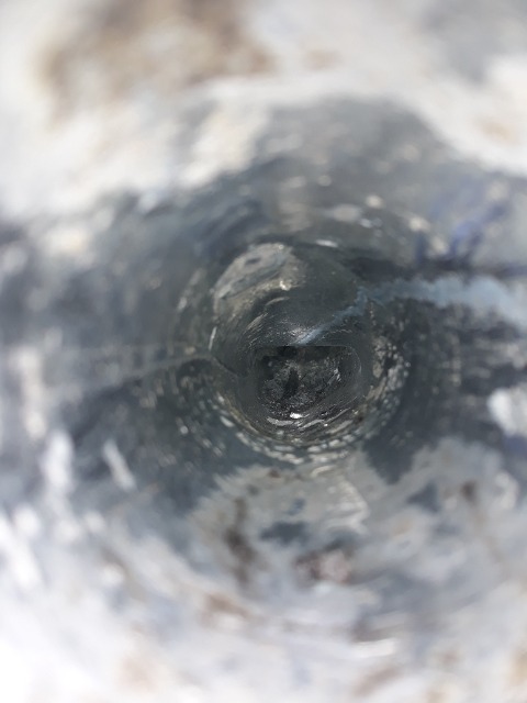

You will need to run a tap through any threaded holes now to make sure they are clear.
