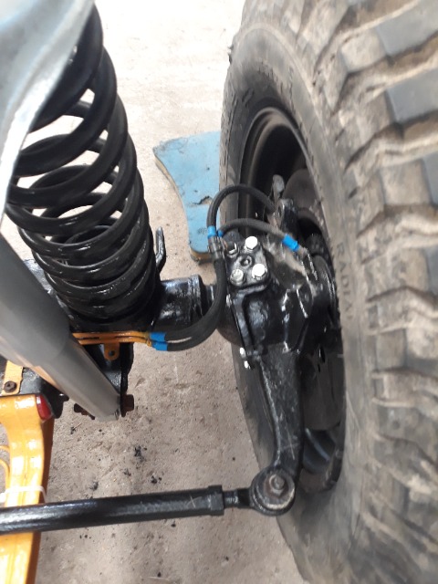

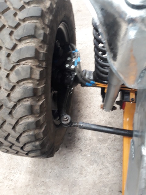

Ok the 2004 M13A and 1999 G13BB power steering boxes are not the same , the banjo fittings on the G13 are smaller than the M13. Had to swap pumps this evening.

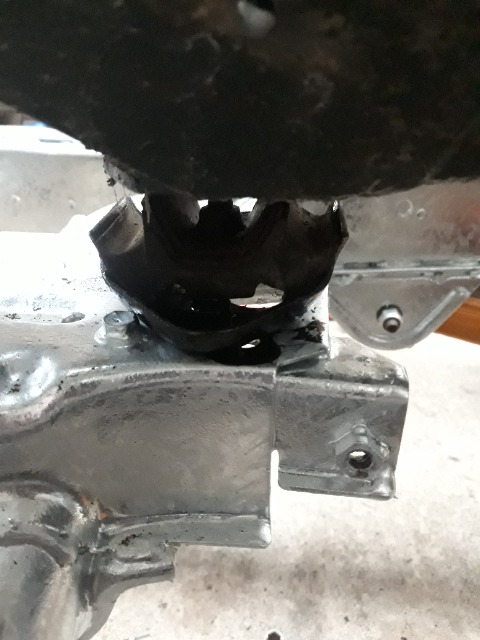

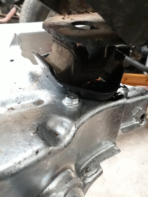

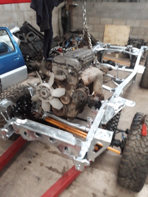

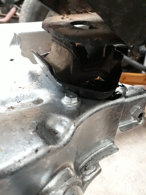

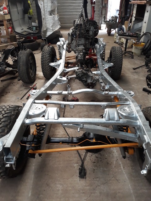

Ok Engine in and Gearbox, Clutch kit ordered and will fit before I go any further. Rear engine mount shot so need to buy a new one and stick in the brake shoes. I think the M13A engine and gearbox is about 10mm longer than the G13BB because when I dropped in the engine and gearbox the rear engine mount didn't line up with the chassis by 10mm.
