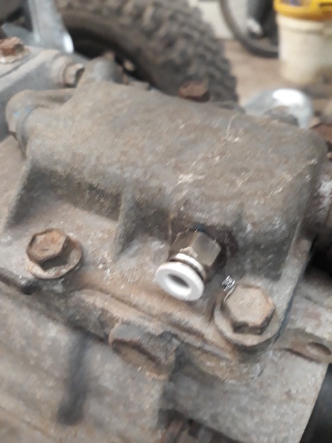

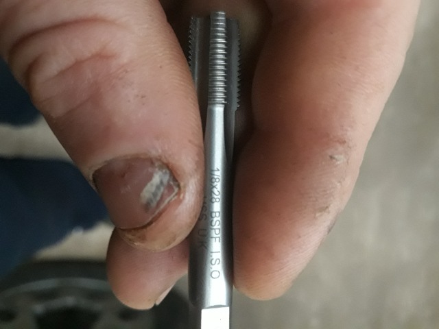

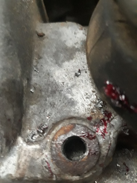

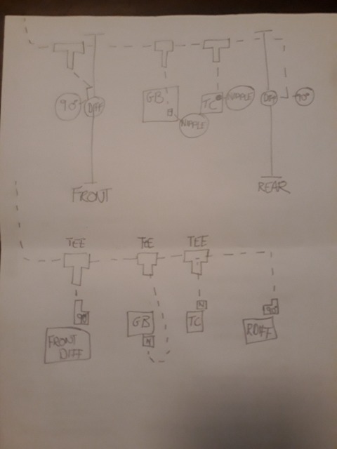

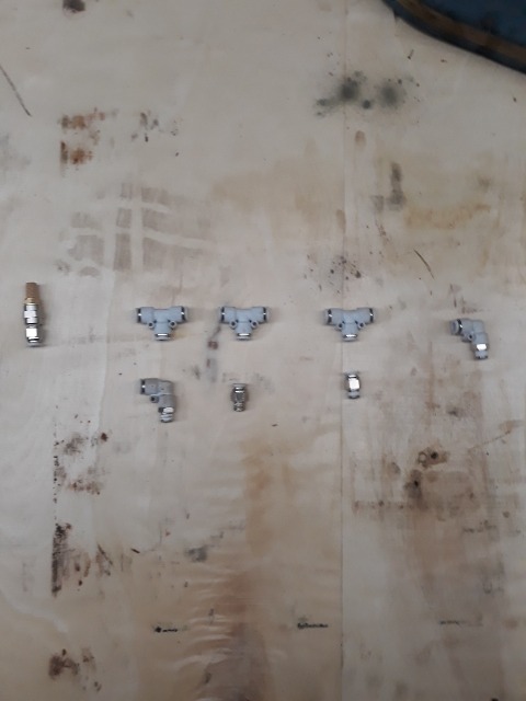

Ok differential breather kit my recipe.
So going to run the entire vent system through one line .
Using 1/8 BPS 6 mm pipe push fittings
2 elbows
2 nipples
3 tees
and a push fit nipple with filter attached. Which ill run up the snorkle .
Used thisto tap the holes .

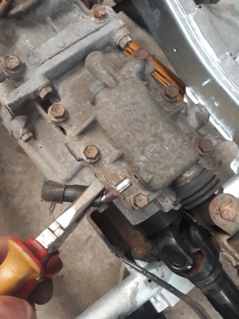

Transfer box
Gearbox you can remove the factory nipple wih a pliers
Nipple installed in Gear box
Diffs are straight forward with the 1/8 BPS tap making thread with no additional drilling .
2 elbows
2 nipples
3 tees
Transfer box

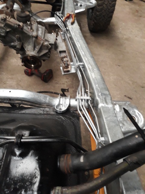

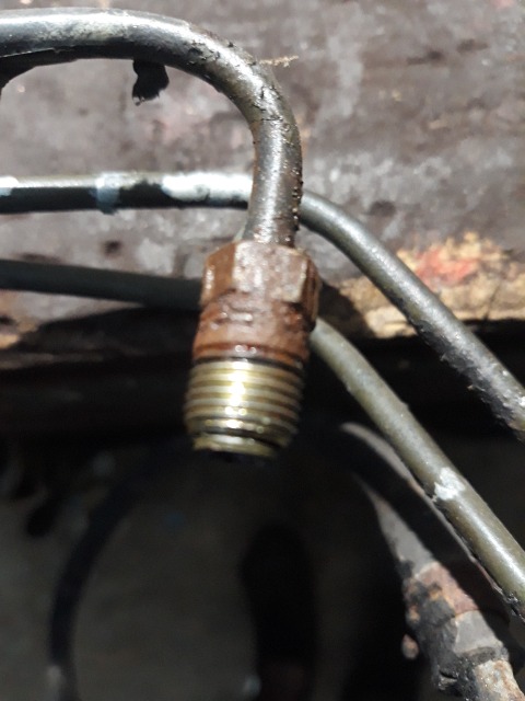

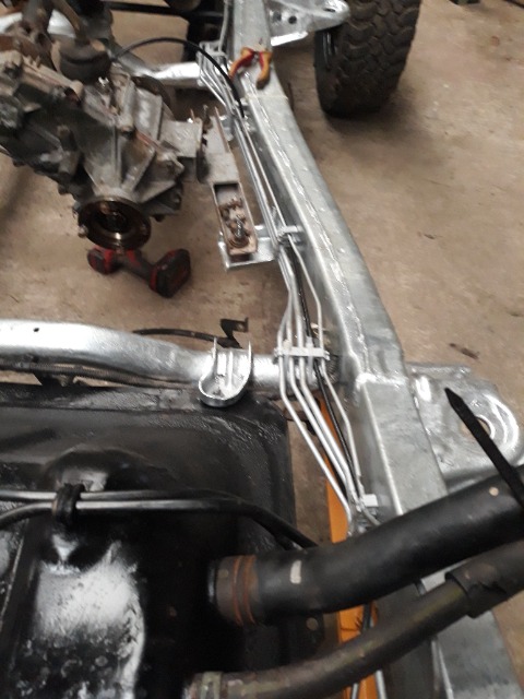

Got the fuel line in and the brake line as well. In 2004 it's a single brake line and in 1999 it's a single line that branches off at the rear into two lines. I had rounded the brake line nuts in the two-way splitter under the driver-side floor area so I needed to get them out and make up a new line.

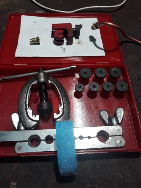

Friday night went online and order a flaring kit, some copper line, and some brake nuts from Halfords and picked up Saturday morning. Really important to BUY A PIPE CUTTER.

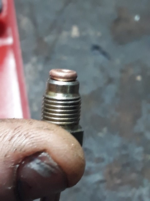

I ended up having to scavenge brake line nuts off the other lines because there's a small difference between the Halfords nuts and the Jimny nuts. Halfords brake line nut notice the 3 mm at the end of the nut
This is the jimny nut and that 3 mm makes all the difference
Other wise the flaring tool is easy to use and does the job all in all not bad for €30 and the copper pipe and nuts another €20 so affordable and a good set of tools to have .

Work has me getting up going out coming home getting up going out coming home getting up................. the last couple of weeks however hoping to put the body on this weekend.
Made a new brake line and did the bolts that hold the hand brake cable onto the cross member plus found a braided stainless steel brake hose.
