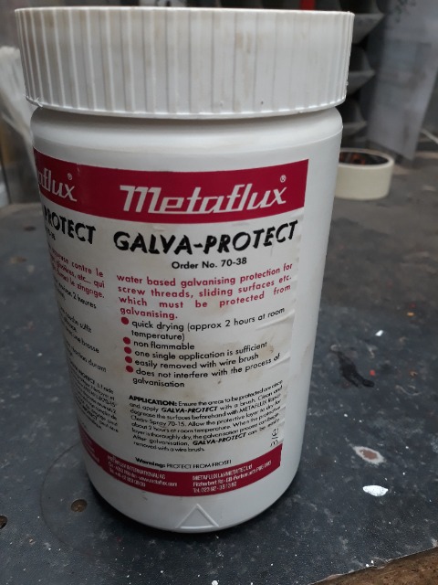

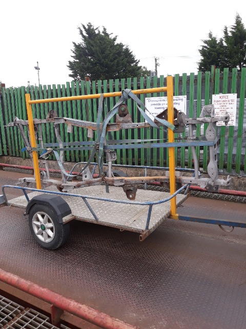

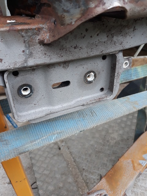

Used this to protect the threaded captive nuts etc .
On the weight bridge
turns out there going to blast it again and will touch up any areas that need it so despite my best efforts they dont want it to leave the plant in less than 100% galvanized. He also told me they bulk bath chassis over the weekend in acid to ensure the internals get well eaten.
We will see on Monday?
Replied by Dirtbird on topic BODY SWAP a 2004 M13A onto a 1999 G13BB chassis

Replied by Lambert on topic BODY SWAP a 2004 M13A onto a 1999 G13BB chassis
48h in an acid bath? It's certainly going to be clean. Or dissolved!
Yeah, Lambert ...I was thinking that they won't shot blast it and leave it in the acid and charge me for both. ?
Lets see.eh.
Lets see.eh.
