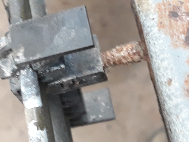

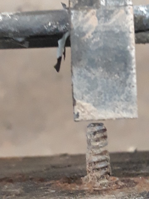

Hey Facade thanks. Right my pipes are all ok as the Jinmy was driving up to 2 weeks ago. ok im trying to keep em but i heard you that they are brittle.
25 Jul 2021 06:26 #236942
by facade
Replied by facade on topic BODY SWAP a 2004 M13A onto a 1999 G13BB chassis
I would change them if they are the ones in the last picture! They are easy to change with the body off, a right pain with it on.
Use copper alloy tubing, the only thing to watch is suzuki brake pipe fittings are short and threaded right to the ends, the more common type have no threads for the first 5mm, so only screw in a couple of turns.

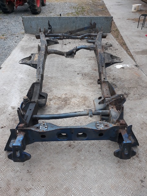

26 Jul 2021 17:52 #237007
Replied by Lambert on topic BODY SWAP a 2004 M13A onto a 1999 G13BB chassis
Excellent work, just demonstrates how effective determination is to getting a result.
- Dirtbird
26 Jul 2021 18:28 #237011
by Dirtbird
Replied by Dirtbird on topic BODY SWAP a 2004 M13A onto a 1999 G13BB chassis
Thanks, Lambert.
- Godskitchen
27 Jul 2021 10:14 #237029
by Godskitchen
Replied by Godskitchen on topic BODY SWAP a 2004 M13A onto a 1999 G13BB chassis
Excellent work, fair play. Where abouts in Ireland are you?
