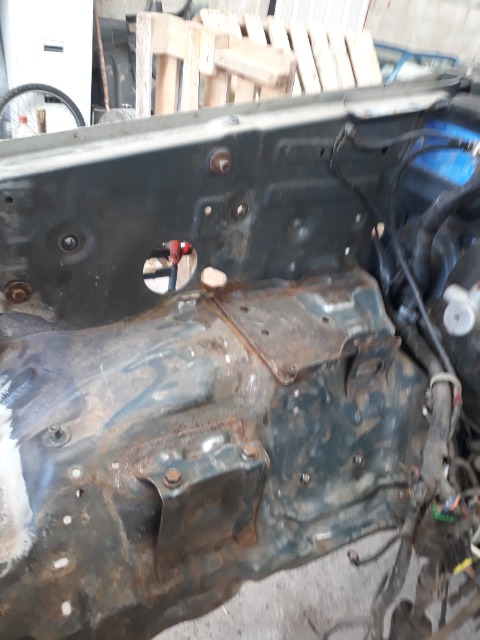

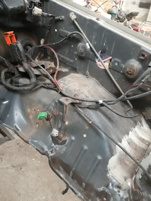

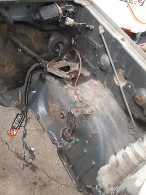

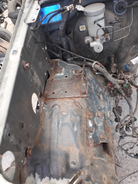

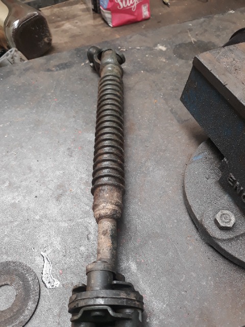

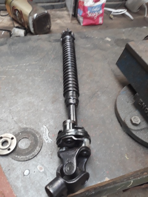

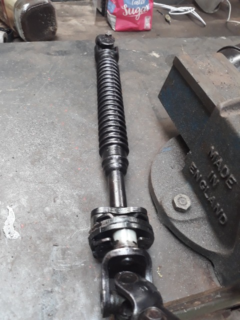

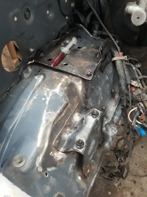

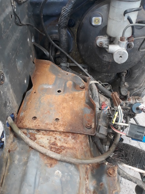

I have some more welding to do but couldn't get into the headspace today so I said I clean up the engine bay, clean up some spot rust and get some rust converter onto them.

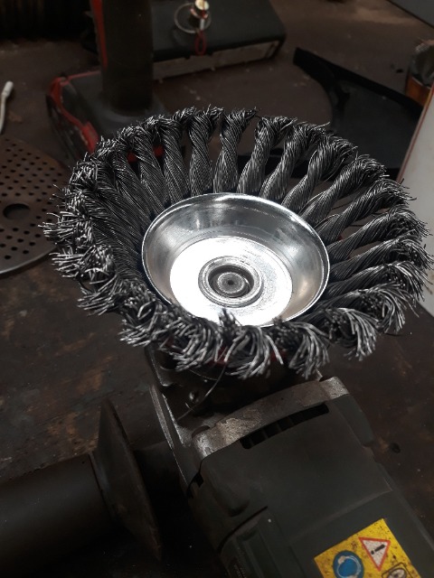

Battery tray, I can't take it off so going to do the best I can with a 4 inch and 3-inch wire wheel brush cup.
Once it's cleaned down going to wash the engine bay with some washing liquid and warm water let that dry. Then hit it with KRUST the Hammerite rust converter let it dry and hand paint the engine bay after a rub down with sandpaper and a wash down.

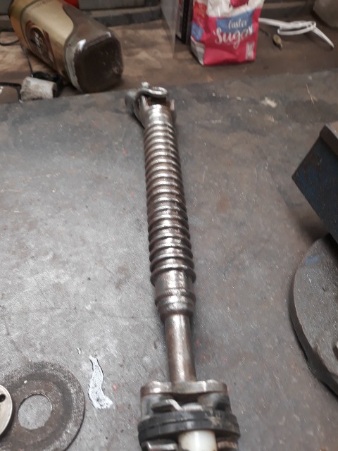

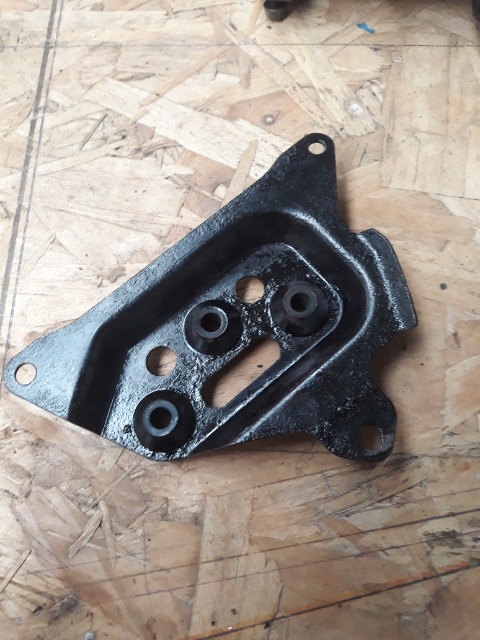

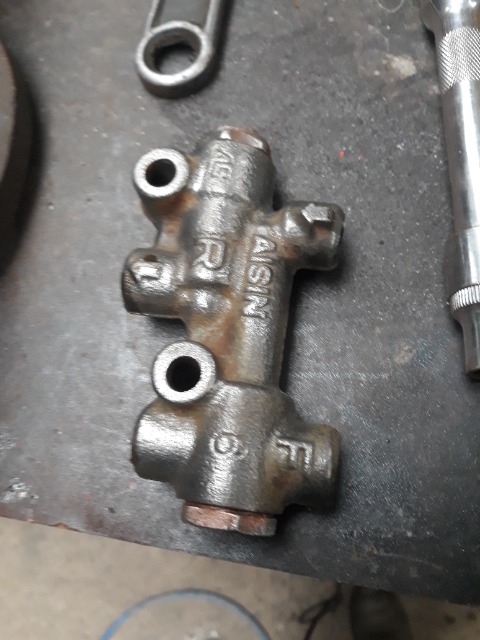

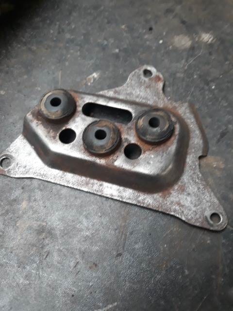

Steering link arm before wire wheel cup brush

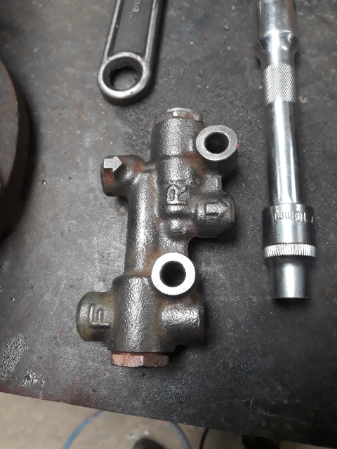

This is the gizmo
This is the gizmo

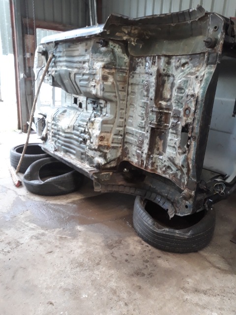

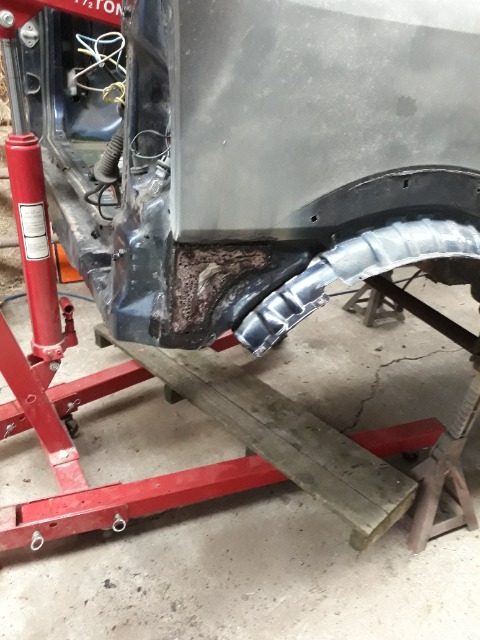

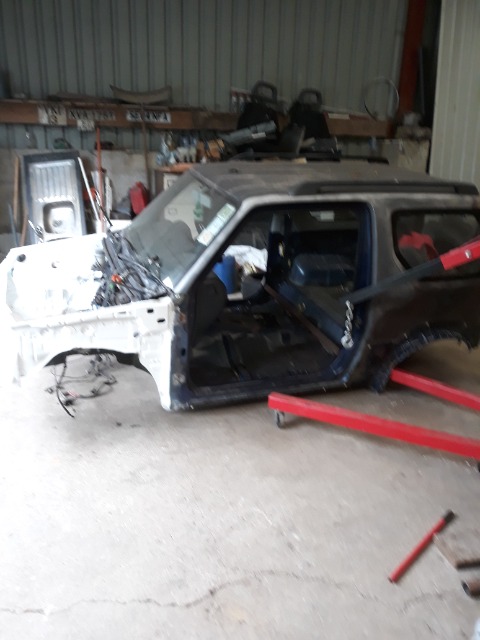

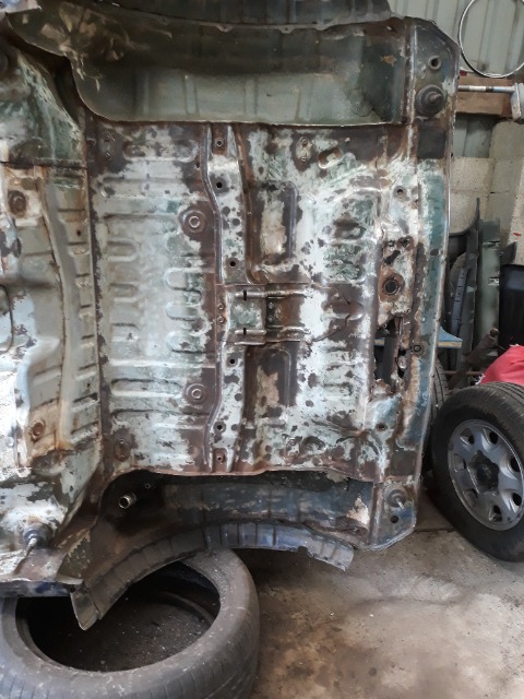

Welding generally working on cars is so much better when you are comfortable, which with the body off looks easy.
- Dirtbird
07 Aug 2021 00:19 #237355
by Dirtbird
Replied by Dirtbird on topic BODY SWAP a 2004 M13A onto a 1999 G13BB chassis
Finding the welding tough as im using flux core 0.9 wire . Ive to be really quick with the stitches and it's just about doable with the body off cannot imagine how people do it with the body on .Welding generally working on cars is so much better when you are comfortable, which with the body off looks easy.
