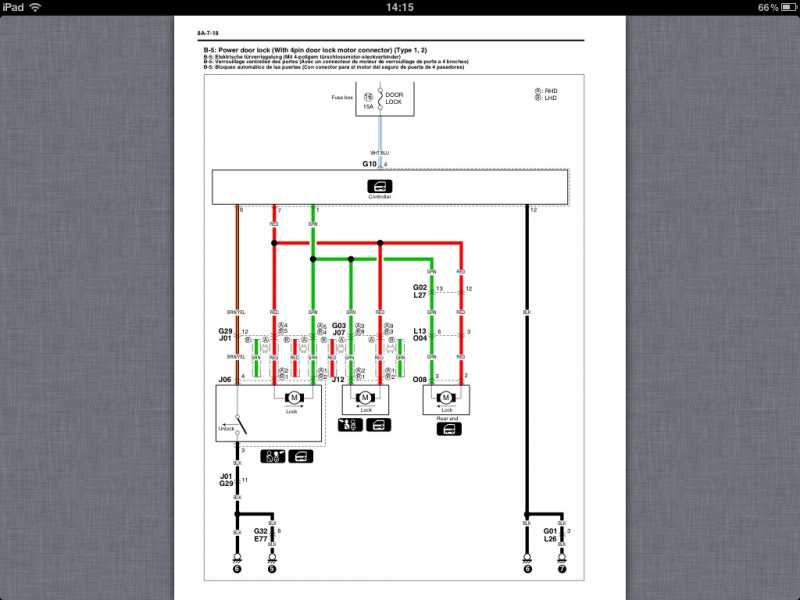

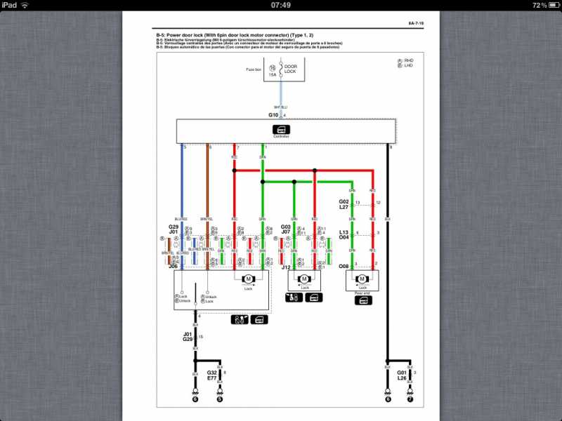

Thanks for that Happypig. My only trouble is that the early jimny's don't have 6 wires they have 5. So I am missing the lock wire (blue with red stripe). I have got it to unlock but not lock.

Thinking about it, you should be able to wire a 6wire controller in with one of the remote central locking units if you can get one off a breaker

Thanks for that, I think you've hit the nail on the head. I'll have to see wht I can get hold of.
There are 3 spare ports on the suzuki jimny controller so they may be all the same I might just need the door wiring and door central locking motor. hmmm
