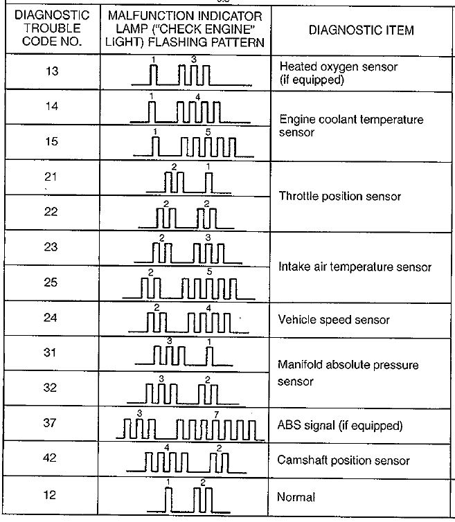

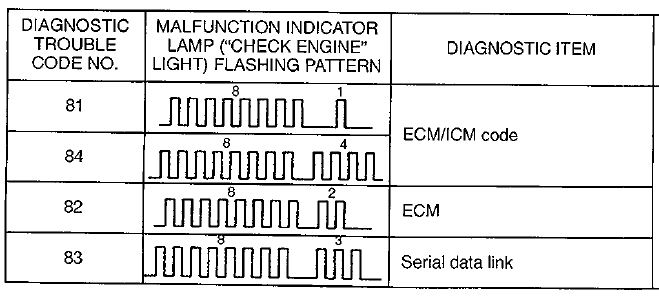

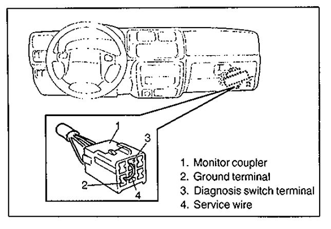

This is how you get codes on an OBDI Jimny - the monitor coupler is behind the glove box, you insert a jumper wire (#4) in to the connector so that it connects the diagnosis terminal (#3) to ground (#2) and then switch the ignition on, the check engine light should flash.
If the ECU detects no faults it should flash a "Code 12", which is one flash, followed by a short pause and then two flashes, followed by a long pause, and this will repeat.
Some codes, like the #42 for the cam position sensor are not detected unless the engine is cranked, so if you get a code 12, crank the engine with the jumper wire in and then look at the flashes before switching off to see if they have changed.
