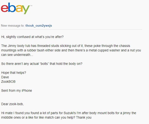

This MUST be you...

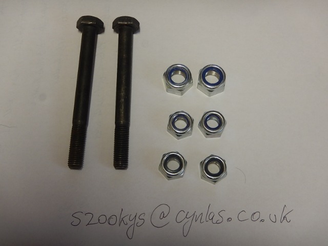

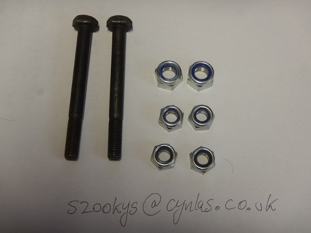

Here you go!
Metric fine (the thread that Suzuki use just to be awkward!)
Two bolts to go under the headlights into the chassis cupped mountings as yours will now be too long
Four 10mm nyloc locking nuts for the small body mounting studs, and...
Two 12mm nyloc locking nuts for the small body mounting studs
And below is my paypal email address, a tenner should cover the parts and postage ;)
Hope that helps!

That's no me on ebay mate I have just found this out today.
