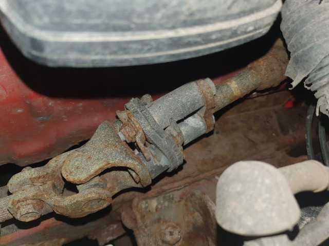

I can’t see in the photos, but are there bolt-in spacers to make the steering shaft longer for the 3” lift? I suspect there would be for a 3” lift? That would now make your steering shaft TOO long, hence why the body isn’t dropping down...

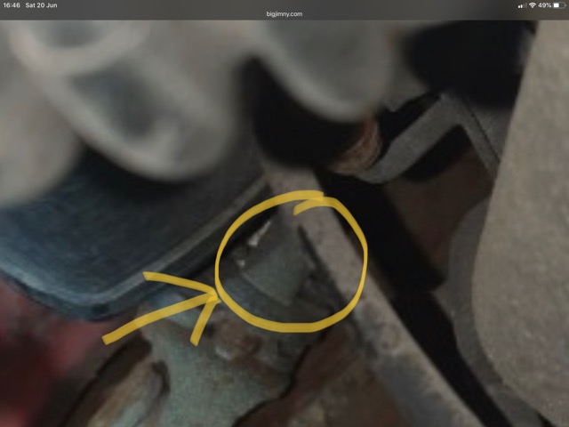

Also I have gave up trying to get the nut on the top of the pro comp shocks on the front cant get it to come threw fat enough to get the nut on any ideas please. Ok I also must say it is staying on the ramp for the time being until I get the 3" springs and shocks for the rear hope that's no it cause I dont have the rear 3" springs in I fell like I will have to give it the body lift again to sort it out

It says on the ebay pic after a body lift remember I have took the body lift out will I need to reinstate the lift to sort out the steering if so I dont want ot to high for the rd and undrivable
