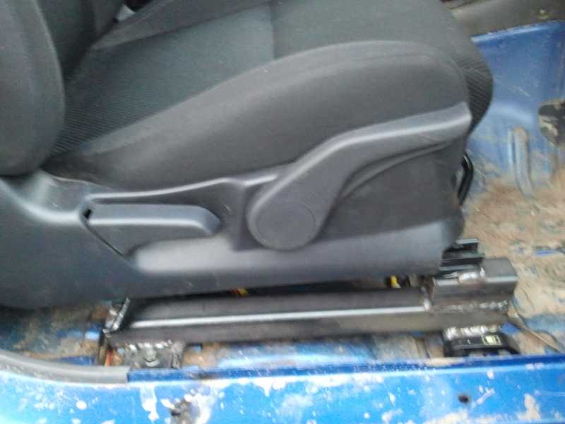

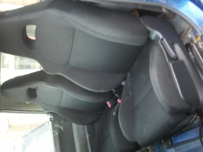

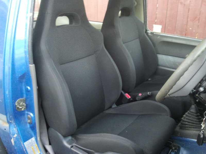

Smoggy wrote: Fitted my Impreza seats yesterday. Thanks to Sponnie's how to guide which took a lot of guesswork out of it and saved loads of time (it was still a chew on lining everything up mind).
Looks nice.
How much higher are you sat now?
  • Smoggy
06 Jun 2013 22:09 #73028 by Smoggy
Replied by Smoggy on topic What did you do to your jimny today
Looks nice.
No higher at all really as the inside runner is exactly the same height and mounts directly to the floor. The outside runner needed building up by about 80mm as the Impreza runners sit level and the Jimny floor drops off to the outside. Also that large lever at the side of the seat raises and lowers it :)
