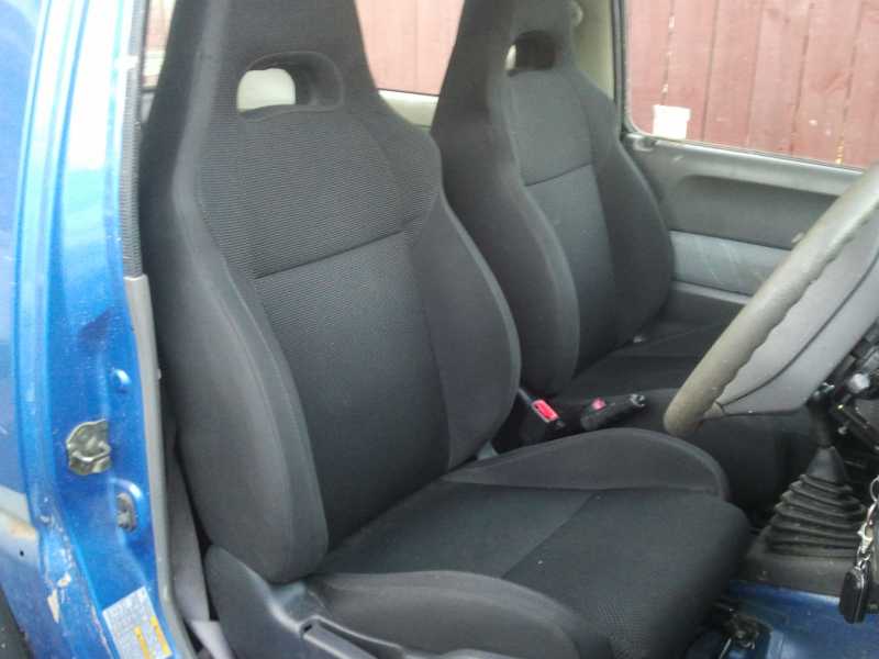

Fitted my Impreza seats yesterday. Thanks to Sponnie's how to guide which took a lot of guesswork out of it and saved loads of time (it was still a chew on lining everything up mind).

Those look well comfy !good job !

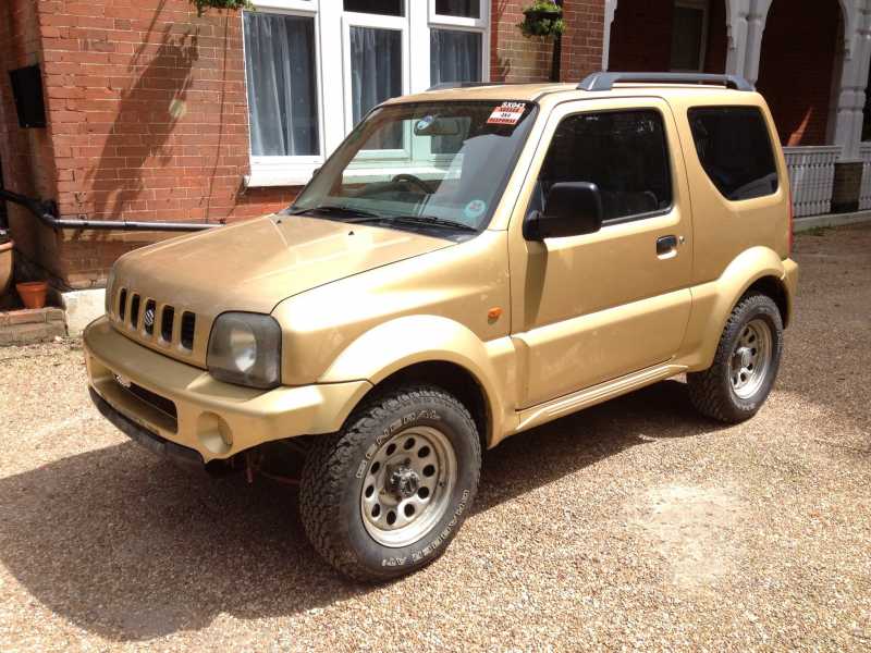

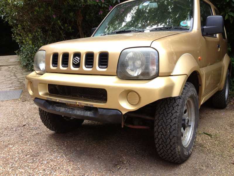

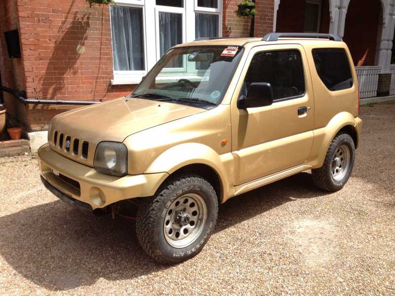

This morning I finished off fitting the spring spacers so the lift is now complete & while the front bumper was off I gave that a bit of nip & tuck plastic surgery.

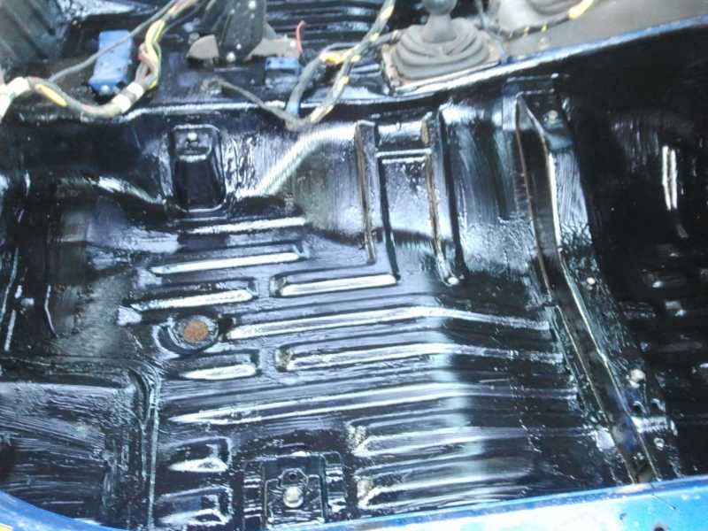

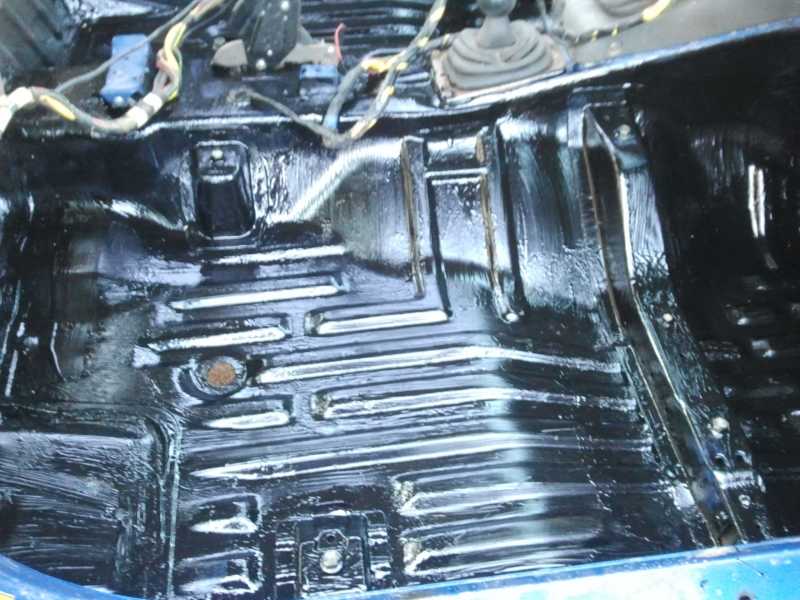

I removed everything back to the bare floor and sanded it back to almost bare metal then applied rust converter to any dubious surface rust. This left a few small (4cm x 4cm) holes to weld up. I also gave it a first coat of epoxy mastic 121 from rust.co.uk before welding the small holes and applying the final coat tomorrow:
