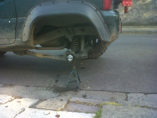

Tell tale leaking of Axle oil on rear N/S wheel ... suspected wheel bearing gone .. so half-shaft whipped out, ready to take to friendly local garage on Monday with new bearing and ABS collar to be fitted by them :)
