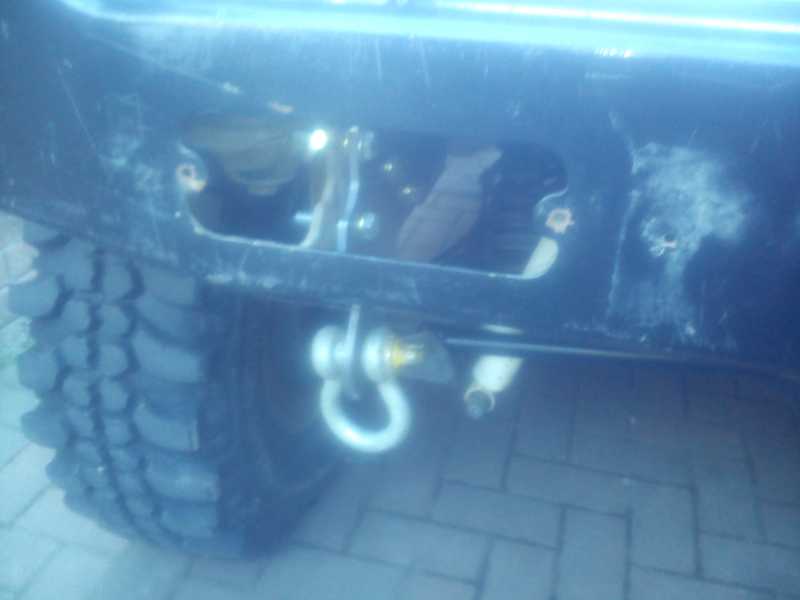

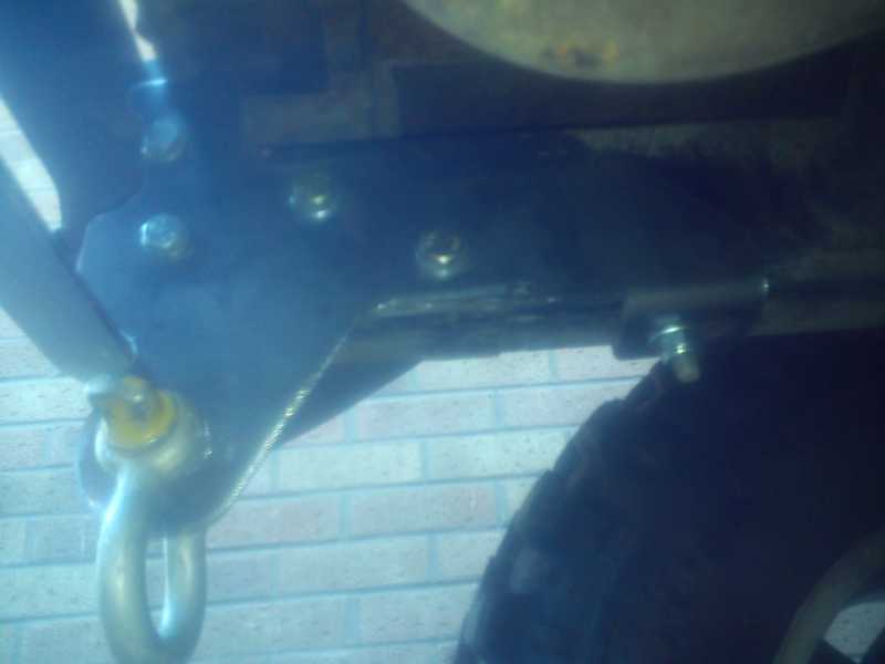

Got any pics of these rear recovery points? :)
  • supergaz
02 Jun 2013 18:25 - 02 Jun 2013 18:53 #72491 by supergaz
Replied by supergaz on topic What did you do to your jimny today
Special order ORA recovery points to suit the older MK1 rear bumper, I had these ordered to suit a +2" Bodylift.
If you have the MK1 rear bumper, then these are the best recovery points to have. :P :P :P :P :P
I re-drilled the original brackets to sandwich the chassis with the new recovery points, also getting the bolt into the bottom hole on the chassis required someone skinny to reach into the chassis rail, so I welded a piece of bar to the bolt so I could get the bolt in place and to enable me to tighten it all up.
These are not on the ORA website, But contact ORA if you want some ;)
