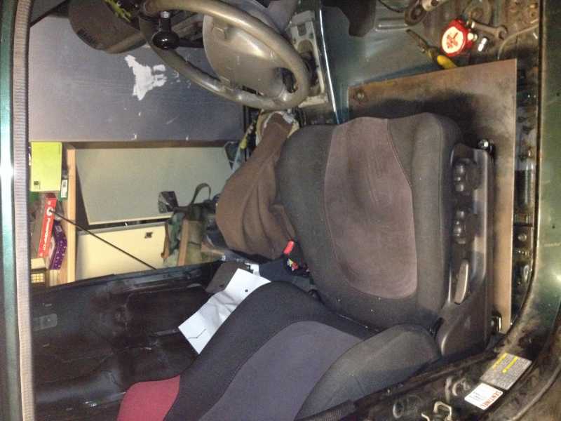

I've had a fiddle with my Recaros tonight, it looks as if the only part to modify is the rear seat back adjuster bar as the Ignis bar is splined and the Jimny bar has tabs on to operate the adjuster and it seems about 40mm too short so I will need to lengthen them. Thank god I got my mig welder back!
