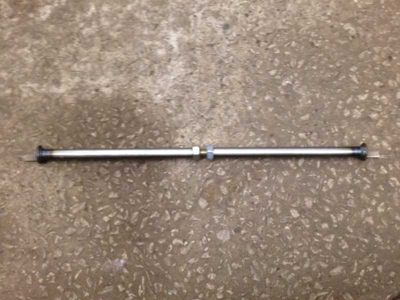

I've had a fiddle with my Recaros tonight, it looks as if the only part to modify is the rear seat back adjuster bar as the Ignis bar is splined and the Jimny bar has tabs on to operate the adjuster and it seems about 40mm too short so I will need to lengthen them. Thank god I got my mig welder back! :)
I ditched all the Ignis seat frames and modified and fitted the seats to the Jimny frames. I cut my standard Jimny bar, tapped the inside of each end and used threaded bar and lock nuts to make the longer. (Not sure if later Jimny seats use the same spline design at the Ignis?)

Fitted my drivers side recaro, only had to extend the bar, similar to you bit lazy and just welded a bar inside. Not had to trim anything as it all lined up nice. These seats should have been fitted to the jimny from the factory! They are so comfy! And the perfect fit :-)
