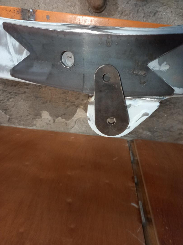

more progress, chassis is finished and ready for paint, i welded up the stiffeners inside the chassis first, then closed up the opening and ground it down then made some stiffeners to weld on the out side just to make sure
i used 5mm plate which i think is overkill but it makes the side of the stiffening plate in the same plane as the radius arm brackets so that then makes it easy to drop a bracket down to beef up the radius arm mount which i seem to remember folded over very easily on my first jimny when you started to get serious off road
something like that but with a bigger drop plate, maybe 2 or 3 holes so i can move the radius arm fixing bolt forward when i go to longer springs

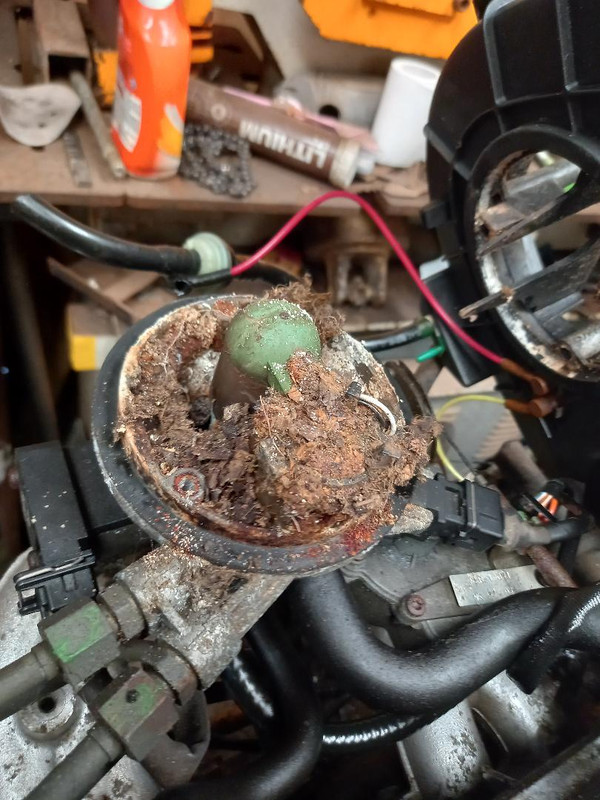

Well that sucks. Might be worth pulling the inlet manifold to see if mouse pee has managed to get into the engine.
Just a thought with CVT - they use an automatic clutch to take up drive. If you do a lot of low speed manoeuvring off road you could overheat it.

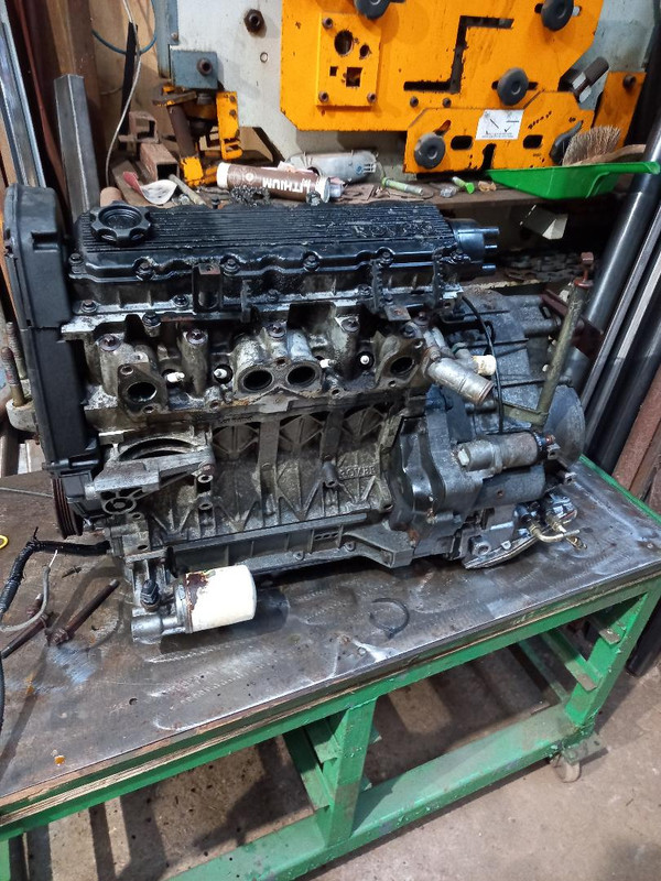

ive dropped off both manifolds engine looks ok on the inlet side, early rover 100's had an Su carb , will try and find one along with the manifold, its a nice small light engine, would like to use it if i can if not plenty of others out there
i think the transmission will hold up, keen to experiment with it
