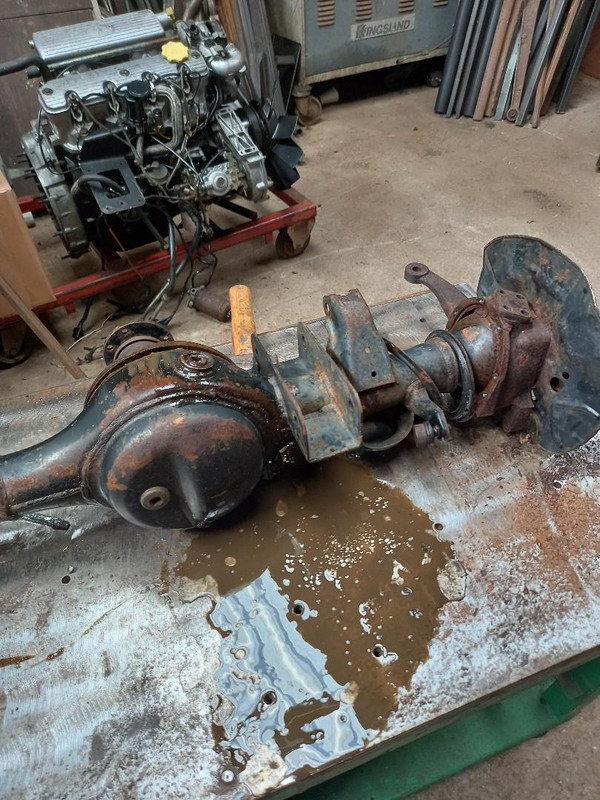

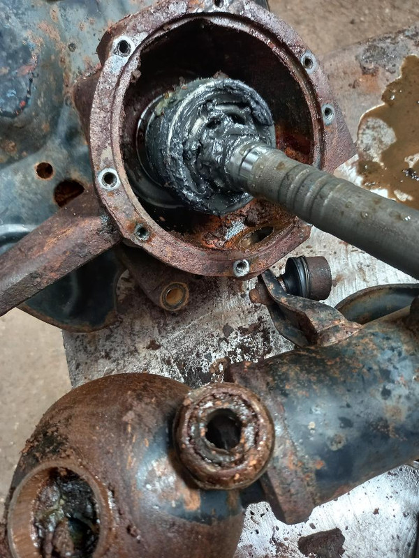

well i thought i was just going to jet wash the axles paint them and pop them in............. how stupid of me
while the front was on the bench l tried turning the pinion ..... it would only go half way then go really tight...
better open them up and have a look l suppose
plenty of water in with the oil
and plenty of sand packed in the hubs
but im sure i can sort it out

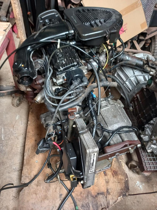

I really hear you man. The other thing that happens to me is, "while I have it out you'd be best off replacing ........everything.
Your build is interesting to me because I find it difficult to understand the ecu etc and how you are going to make the ecu think everything is ok now please start engine.
19 Sep 2021 21:30 #238810
by LesNewell
Replied by LesNewell on topic lightweight buggy
Transplanting engines with ECUs isn't too bad if you have the whole donor car. I've done it a few times. Basically I carefully pull out the whole loom then plug everything together on the floor and make sure the engine still runs. After that it's a case of referring to the wiring diagrams and stripping out everything that isn't engine related. Immobilisers can be a pain, especially if they have a few sneaky undocumented wires in there just to catch you out.
Baloo, what engine + box did you go for in the end?
